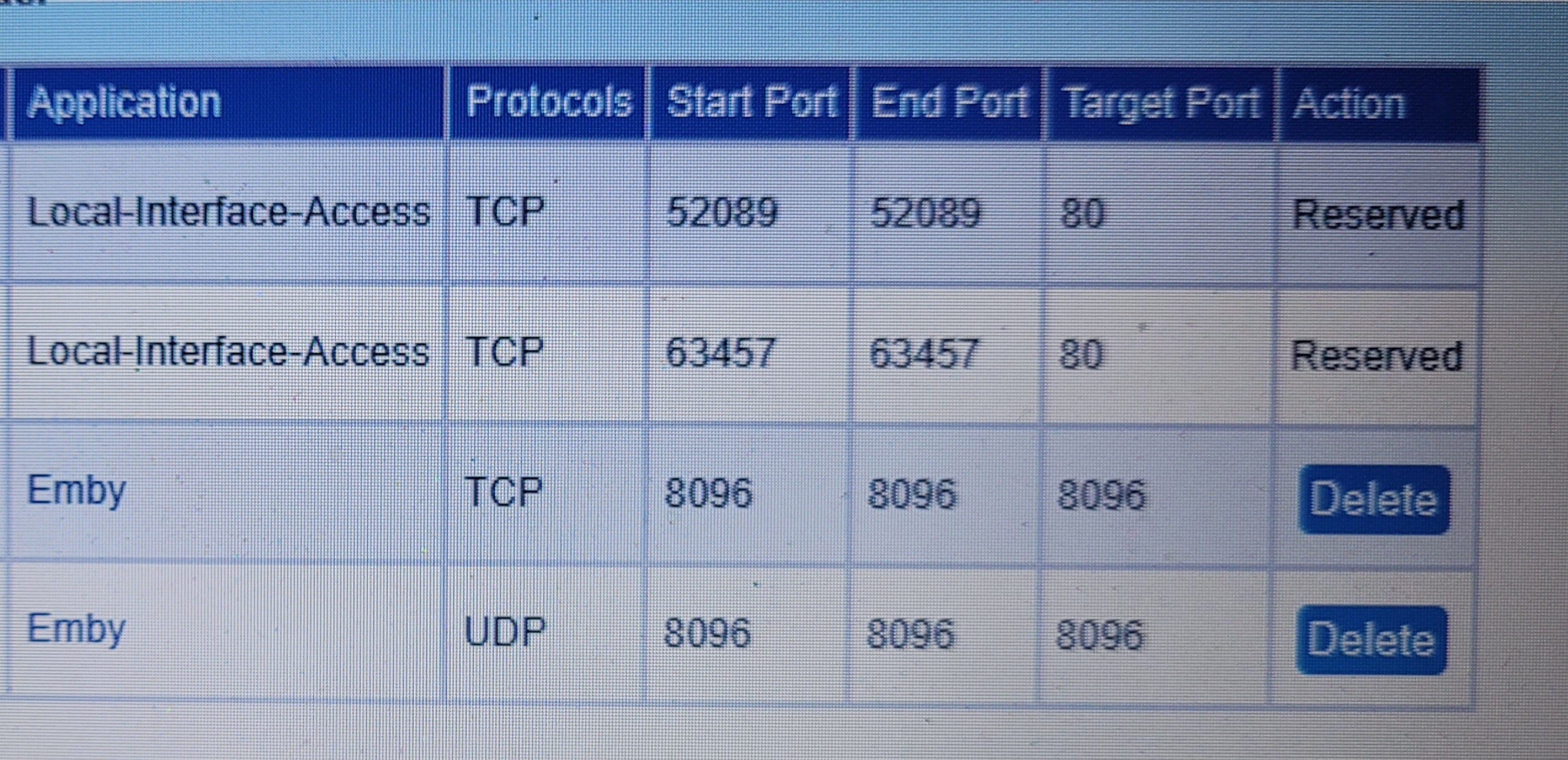

davelee 1 Posted September 7, 2023 Author Posted September 7, 2023 Ok. So I went back through the steps. I guess the one thing I'm unsure of is the start and end port. I've attached a screen shot to show what I have. What you don't see is my personal laptops operating address but that is assigned. When I chose both tcp and udp, it separated them into 2 different lines when I saved it. From there, when I go to the canyouseeme.org it says it cannot. It gives me the same response as when I try accessing it on my computer with the remote ip address. They both tell me "connection timed out." I'd be really curious as to what is happening.

pwhodges 2023 Posted September 7, 2023 Posted September 7, 2023 What does canyuoseeme.org say if you ask it about the Emby port (8096)? Paul
davelee 1 Posted September 7, 2023 Author Posted September 7, 2023 I just tried that as I saw it was Port 80 before. Same response for 8096. Connection timed out.

Solution davelee 1 Posted September 7, 2023 Author Solution Posted September 7, 2023 I got it! I had to go in and add Windows Firewall rules for the IP Addresses and Ports. For some reason it was still blocking it despite me having them all set to off. Crazy! Appreciate the help!! 1
