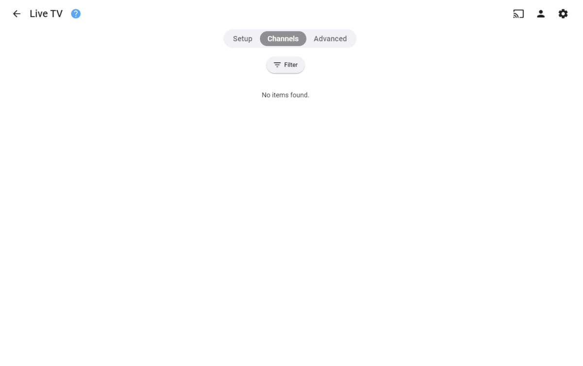

Luke 42242 Posted September 6, 2023 Posted September 6, 2023 Do the channels show up in channel management under live tv setup?
Fin7645 5 Posted September 6, 2023 Author Posted September 6, 2023 12 minutes ago, Luke said: Do the channels show up in channel management under live tv setup? Nope nothing under channels tab in live TV setup. I've look though the entire list and sadly no locals.

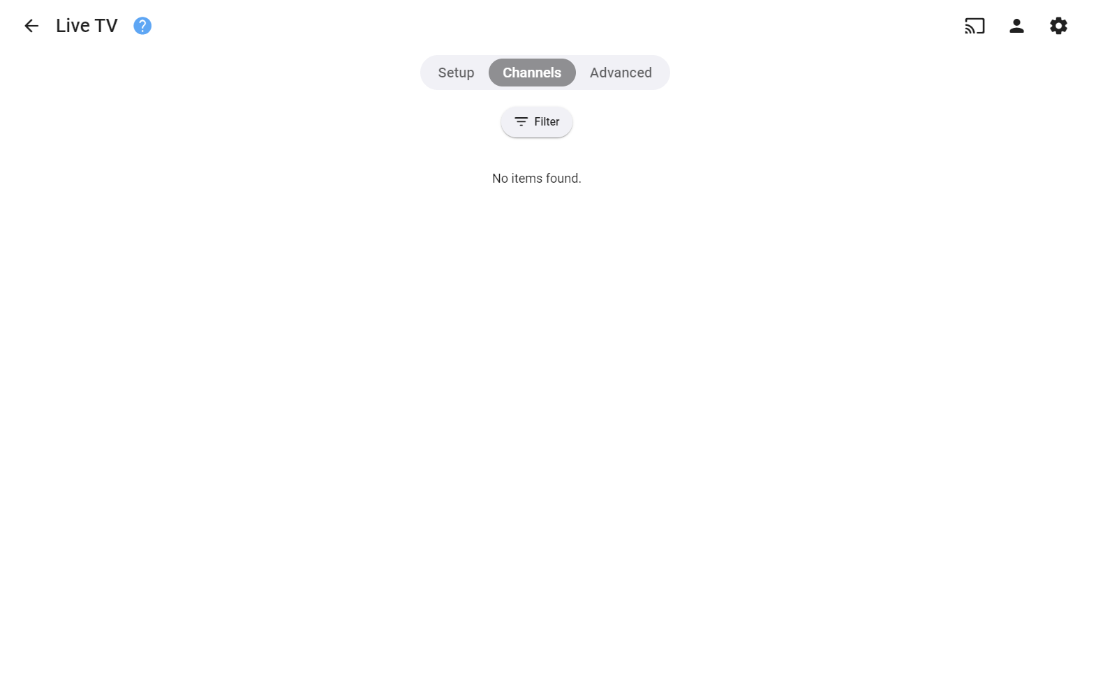

Luke 42242 Posted September 7, 2023 Posted September 7, 2023 Can you show a screenshot of the channel management tab?
Fin7645 5 Posted September 7, 2023 Author Posted September 7, 2023 25 minutes ago, Luke said: Can you show a screenshot of the channel management tab? it's blank

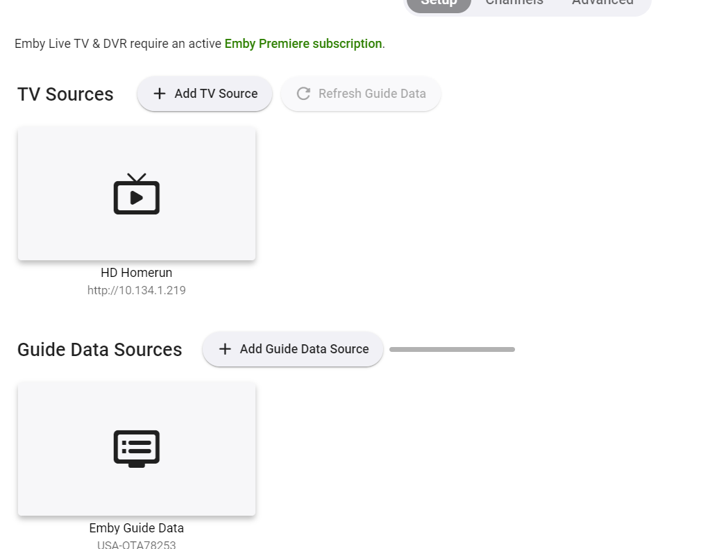

Luke 42242 Posted September 7, 2023 Posted September 7, 2023 Are you sure the refresh guide completed? I didn't see that in your provided log. I saw it was stared, cancelled, then started again, but the log ends shortly thereafter.
Fin7645 5 Posted September 7, 2023 Author Posted September 7, 2023 1 minute ago, Luke said: Are you sure the refresh guide completed? I didn't see that in your provided log. I saw it was stared, cancelled, then started again, but the log ends shortly thereafter. Yup, I see a gray bar next to add guide data source. it never fills in, just there for a second or two and gone the next like in the screenshot.
