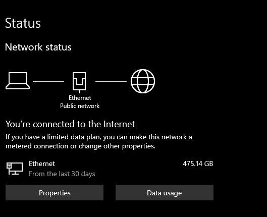

justinrh 263 Posted August 6, 2023 Posted August 6, 2023 On 8/5/2023 at 12:01 AM, Zuglord said: this appears to include LAN access as well It might be import to figure this out first. To be sure, is your network profile Public or Private right now?
Zuglord 4 Posted August 7, 2023 Author Posted August 7, 2023 (edited) Hello @pwhodgesI have dedicated this IP to my machine on local network. I have dedicated IP (not dedicated but static) via VPN service that also worked prior to August 1st. Now system fails to connect regardless of VPN connection, via both intranet and remote. @justinrhOver the course of the last few days, i have tried both private and public. I believe i was on private prior to these issues, and think i have made settings appropriate, or at least how they were before things stopped working. No change in connectivity, there is none. @Luke unfortunately, no. I remain in the same situation, able only to play on my local machine . I have attached updated logs. I appologize for not being as responsive as i would like to be but will attempt any and all suggestions. Thank you all for your time and effort. embyserver-63826959062.txt embyserver (3).txt Edited August 7, 2023 by Zuglord added logs
