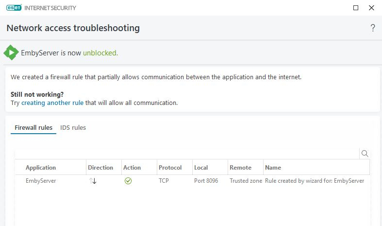

musicmafia 38 Posted August 3, 2023 Author Posted August 3, 2023 I wasn't having any luck manually but I decided to take a deeper dive into the antivirus program (eset) and did indeed find that eset was blocking network access. It's the same prgram I've used for years and know idea why suddenly it did this. The only thing different I could see was the eset program updated yesterday and that's when the problem started. So I ticked the UNBLOCK box and it said it allowed "partial" communication. I tried opening Emby on the TV and still unable to connect. It said "Still not working?" create another rule, so I clicked that. Only with this last setting (above) would it allow me to connect. Is this safe for me to leave this setting as is in the AV program?

musicmafia 38 Posted August 5, 2023 Author Posted August 5, 2023 19 hours ago, Luke said: Have you explored the options in the TV app? I went to startup settings and the box requiring password was unchecked but the box logging out after a period of time was checked so I just changed that to "never." I p[resume that is the correct fix? PS Are my firewall settings okay above? Thanks
Solution musicmafia 38 Posted August 13, 2023 Author Solution Posted August 13, 2023 2 hours ago, Luke said: Were you able to get connected? Thanks Luke, yes, I changed my firewall settings and all good now. 1
