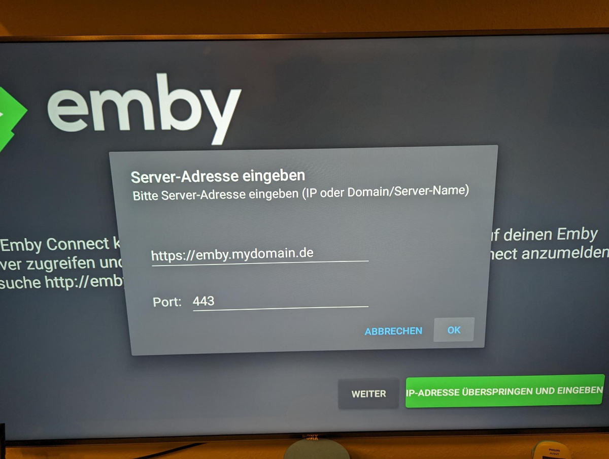

ionfan2000 0 Posted June 15, 2023 Posted June 15, 2023 Hello. recently my emby app won't login anymore into the server. So i cleared all caches and file storage on the Android TV and restarted the app. After that i am presented with the "Connect with Emby Connect" Screen. There i chose to login via IP-Adress (the german translation for that button needs to be improved ) After that i put in https://emby.mydomain.de and port 443. When confirming these settings nothing happens and the "connect with emby connect" screen is still showing. No error message or other reaction. The app also stays responsive to my inputs. My server is internally resolved to a local ip address and there it is run as a docker container with traefik as a reverse proxy. I can access the emby GUI from everywhere in the world and also in my local network. The only thing that is not working is the app on my TV. In the emby log i can see the following log-lines that may correnspond to that: 2023-06-15 06:32:11.064 Info Server: http/1.1 POST http://host1/emby/Sessions/Capabilities/Full?X-Emby-Client=Emby Web&X-Emby-Device-Name=Firefox&X-Emby-Device-Id=44c78b08-9d42-4e87-be55-da6a2d9a88b9&X-Emby-Client-Version=4.7.13.0&X-Emby-Language=de&reqformat=json. UserAgent: Mozilla/5.0 (X11; Linux x86_64; rv:109.0) Gecko/20100101 Firefox/114.0 2023-06-15 06:32:11.065 Info Server: http/1.1 Response 204 to host2. Time: 1ms. http://host1/emby/Sessions/Capabilities/Full?X-Emby-Client=Emby Web&X-Emby-Device-Name=Firefox&X-Emby-Device-Id=44c78b08-9d42-4e87-be55-da6a2d9a88b9&X-Emby-Client-Version=4.7.13.0&X-Emby-Language=de&reqformat=json I attached a screenshot of the emby connect screen where it stays after entering the connection details. My TV is a Sony KD-55XF9005 Can you tell me how to get more information what the client on the tv does? Right now it is a blackbox and i have no clue what the problem is. Regards ionfan emby-screenshot

ionfan2000 0 Posted June 15, 2023 Author Posted June 15, 2023 After entering the url and port to my emby server like in the screenshot, and then press "ok" the url window dissapears and i get the "connect with emby connect" screen again. There is nothing happening. I assume after pressing ok i should be asked for the credentials for my server but that is not happening.
