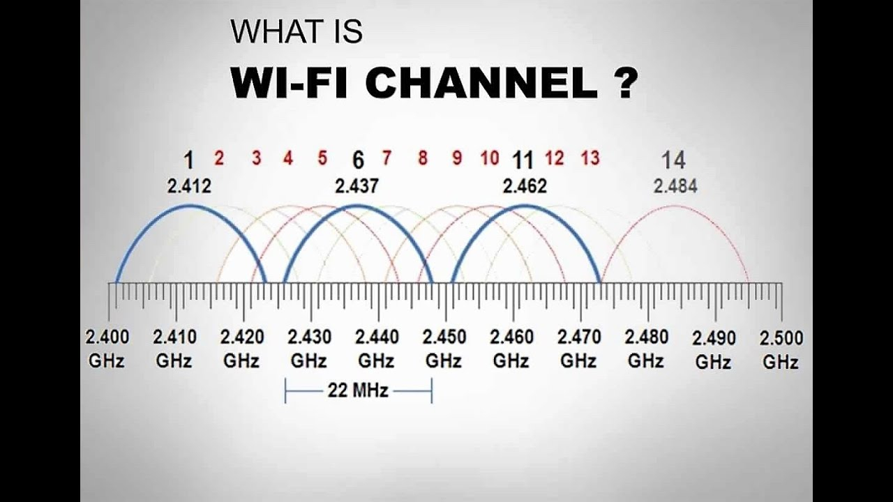

scott46953 31 Posted December 11, 2025 Posted December 11, 2025 In order for it to work like other streaming apps since those seem to work for you and you're pointing at the buffer on emby.. emby uses a different type of stream than those other apps. It requires a constant data stream. Example, you may have a fiber line with 1000 MB up and down but you got a Wi-Fi router, your daughter has a laptop a phone and her own TV connected to the Wi-Fi she decided she wants to update her Sims game and wants to download 20 gigs at Max speed. Her laptop can only take 20 to 30 MB from your router leaving you with a trickling speed to watch emby with. Yes routers are supposed to prioritize video and audio but they don't always work. And then your lady friend wife whatever, has her phone and tablet connected at the same time, she decides it's time to go to work, she walks out the front door jumps in the car, her Wi-Fi signal on her phone goes down to -85 or worse which is trickling between losing the connection.. it stutters the hole wi-fi system and now all the devices are all trickling on 1 MB. And then as she pulls away and loses signal it disconnects causing a 3 to 5 second Wi-Fi pause on all the devices. Before completely disconnecting and the Wi-Fi routers then actually able to spit out 20 to 30 MB again. And then you wonder why? Because you have one Wi-Fi name on a dual band router and even though it's supposed to separate and switch everything between 2G and 5G it still got his glitches and still has everybody running on 2G or you're in the middle of a football game and multiple devices at the location are switching between 2G and 5G causing glitching on the Wi-Fi. And then if you don't have fast internet and you got DSL which seems to run like crap when streaming emby unsteady copper wires going down the road. Or if you're trying to get by with cheap internet because of a budget, now you're capped out with Wi-Fi problems because you need to have separate names for your 2G and 5G. And then you're trying to run it on a budget device that may not have a dedicated video card. So now your transcoding on a device that is not strong enough to transcode on top of all these other issues. I'm not saying that this is your scenario, but I'm sitting in an example for everything that can possibly go wrong including everything going wrong at the same time. If you don't diagnose it and start from the beginning, you're going to scratch your head blame it on a buffer from the client and still wonder why YouTube plays fine. The dev team has not implemented an adjustable buffer on the client side since the beginning, and to be quite honest with you I don't see them wasting their time on adding the option to resolve problem or problems that can be resolved by fixing the actual issues. They would have to rewrite the complete streaming code, and I believe that would break a lot of devices and would not be backwards compatible. I do not see them rewriting the streaming code to adjust a client to try to prevent buffering from ongoing issues. 1

Suliamu 41 Posted December 12, 2025 Posted December 12, 2025 (edited) 8 hours ago, scott46953 said: And then your lady friend wife whatever, has her phone and tablet connected at the same time, she decides it's time to go to work, she walks out the front door jumps in the car, her Wi-Fi signal on her phone goes down to -85 or worse which is trickling between losing the connection.. it stutters the hole wi-fi system and now all the devices are all trickling on 1 MB. And then as she pulls away and loses signal it disconnects causing a 3 to 5 second Wi-Fi pause on all the devices. Before completely disconnecting and the Wi-Fi routers then actually able to spit out 20 to 30 MB again. Sir, if somebody sold to you the idea that WIFI is perfect, then he lied to you. It is basically normal radio. The same your parents used to hear their music in their car. And there is interference if someone else is sending on the same channel. And your WIFI-card in your device works exactly the same as an old radio. It is receiving _every traffic_ on this channel you set it to and then only decides later if the packages it received were meant for you. Yes, also the traffic from your neighbor on this channel, the traffic of some kids drone that is playing outside, and also passing by cars that have wifi on this channel. If you want solid connections try to always use cabled LAN, if possible. And if you want somewhat solid WIFI connections, first what you do is choose an empty channel. And here is another catch: WIFI channels overlap unfortunately by design. That means on 2.4Ghz-Band you effectively can only choose channel 1, 6 and 11. And if you have so called "smart devices" all connected through WIFI then create a seperate WIFI-network on different channel just for those smart devices (which is anyway good practice). And just to be clear: I've got my emby&data at a remote place, not in my LAN, - that means my communication packages go through public communication lines to a city quite far away, and i nonetheless don't have any problems with buffering or stuttering. Those "drops" that you are describing are certainly not normative, especially not in a LAN, but i wouldn't even accept them on my WAN (into the public internet). You need to fix your internal network. And also that you claim that "leaving the WIFI-network" somehow brings your router down, i have never before heard of such a behaviour, and i don't think this is what really is happening. Edit: If you have a quite big area to cover, a big house or something, it would be maybe also a good idea to change to a WIFI-system that has a central controller. A system with a central controller can manage the seamless transition from the area of one AP (access point) to another and it also can manage resources "intelligently" by distribute clients. I know that Ubiquity Unifi does this, but i heard that TP-Link also has such a system by now. This might make your WIFI-experience better. Edited December 12, 2025 by Suliamu
