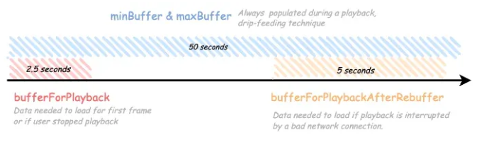

ebr 17032 Posted May 9 Posted May 9 For ExoPlayer (which is what we use on Android devices) it works like this: The min and max buffer are both set at 50 seconds. If that's not enough buffer, then the bitrate needs to be reduced. 2 1
Luke 43549 Posted May 9 Posted May 9 2 hours ago, Q-Droid said: I'm not proposing that you change the apps to display buffer size. Just list them in this thread or somewhere on the site (KB?) if that info is available. That's all. Lack of information is why so many debates in these forums just go on and on. The embedded video player for most platforms doesn’t provide this information. On apps where we embed our own player, we may be able to get it. 1
TMCsw 317 Posted May 9 Posted May 9 4 hours ago, ebr said: The min and max buffer are both set at 50 seconds. If that's not enough buffer, then the bitrate needs to be reduced. Thanks, i didn't think it was this long, but it does explain how I can restart Emby while "direct plays don't get interrupted!" It seems that it would be useless to make the buffer bigger. as everyone is limited to there connection speed. 1
