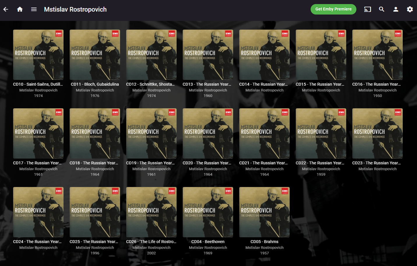

nospotify 187 Posted February 14, 2023 Posted February 14, 2023 (edited) Why is Emby not sorting music albums correctly by Album Title? I have carefully proofed the names for a multi-disk set in MP3Tag, as shown below, but Emby is sorting them as 1, 2, 3, 6, 7... 25, 26, 4, 5. What's broken? How can this be fixed? These are all files that were just added to my music library. When I spotted the problem I reloaded, refreshed, and rescanned. Still the problem persists. Edited February 14, 2023 by wordlover

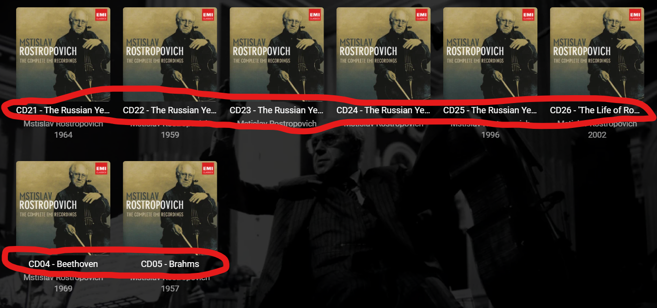

nospotify 187 Posted February 14, 2023 Author Posted February 14, 2023 (edited) What we are looking at are individual albums, from a compilation set, each with an identical cover image. And if you look at the names/titles of those albums, as highlighted in red, the sorting is broken: Emby is sorting the disc titles as CD01, CD02, CD03, CD06... CD25, CD26, CD04, CD05. That is plainly incorrect. I sincerely don't understand your comment. Edited February 14, 2023 by wordlover
