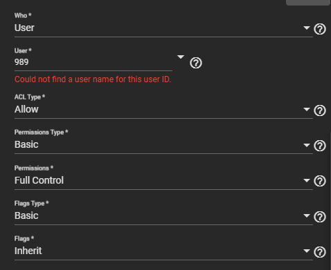

however now that I can sign on to EMBY, new issue i have is I am unable to view my local folders.. i already gave permissions to a user 989 but it does not seem to fix my problem.. still trying to figure that one out.. any suggestions are welcome...image.png.da025788f4f0617da987ba7065a751ac.png

so in addition to me setting permissions and not being able to view my local folders, i figured out the issue.  What i never did was add storage access to jail.. emby software has a help  link to older version of freenas, however i was able to find the info here https://www.truenas.com/docs/core/coretutorials/jailspluginsvms/jails/settingupjailstorage/#:~:text=Go to MOUNT POINTS > ACTIONS,if it does not exist. which is for truenas 13.  it fixed my access issue.. just make sure to stop the plugin first and then go to "mount points" in the plugin menu for emby to link your pool storage.
