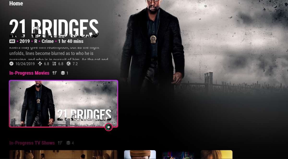

Grumpy1 46 Posted October 14, 2023 Posted October 14, 2023 thanks for the explanation I have a very simply library --- Movies ---Tvshows --- Music and all i was after or wanting ( was not sure if it was possible) was to have anything that is continue watching (movies and tv shows ) to be in one row the first pic is how kodi has it it my setup - In-progress Movies and then a second row of In-Progress TV Shows and was just hoping there was a way to adjust it like in the second pic to combine the In-Progress Tv shows and In-Progress Movies
quickmic 1709 Posted October 14, 2023 Author Posted October 14, 2023 (edited) 11 hours ago, Grumpy1 said: thanks for the explanation I have a very simply library --- Movies ---Tvshows --- Music and all i was after or wanting ( was not sure if it was possible) was to have anything that is continue watching (movies and tv shows ) to be in one row the first pic is how kodi has it it my setup - In-progress Movies and then a second row of In-Progress TV Shows and was just hoping there was a way to adjust it like in the second pic to combine the In-Progress Tv shows and In-Progress Movies Guessing here: What you want has nothing todo with plugin or Kodi limitations. It's just skin configuration. This seems to be a widget setting and/or node settings. Please open a new thread for skin support. Correction, seems to be a node. I'll check. Edited October 15, 2023 by quickmic

quickmic 1709 Posted October 25, 2023 Author Posted October 25, 2023 On 10/14/2023 at 6:56 PM, Grumpy1 said: thanks for the explanation I have a very simply library --- Movies ---Tvshows --- Music and all i was after or wanting ( was not sure if it was possible) was to have anything that is continue watching (movies and tv shows ) to be in one row the first pic is how kodi has it it my setup - In-progress Movies and then a second row of In-Progress TV Shows and was just hoping there was a way to adjust it like in the second pic to combine the In-Progress Tv shows and In-Progress Movies Can you elaborate what's included in this view. Is it in progress movies with and next up episodes? Seems it not in progress episodes.
Grumpy1 46 Posted October 25, 2023 Posted October 25, 2023 (edited) 2 hours ago, quickmic said: Can you elaborate what's included in this view. Is it in progress movies with and next up episodes? Seems it not in progress episodes. in kodi each has its own node so whenever there is any " in-progress anything" it creates a new node in-progress Tv shows in-progress Movies in-Progress episodes for emby- so all in-progress ( movies, tv shows and episodes) would need to be in the same node this is the first kodi skin that i can think of that uses a " Home page" style kind of like what emby or plex do so all of this is pretty new to kodi I'm guessing Like i said at the start... no clue if any of this was possible with the kodi add on , just thought i would ask thanks for looking into this I know i am not the best at explaining things so here is the skin if its easier https://forum.kodi.tv/showthread.php?tid=373859 Edited October 25, 2023 by Grumpy1
