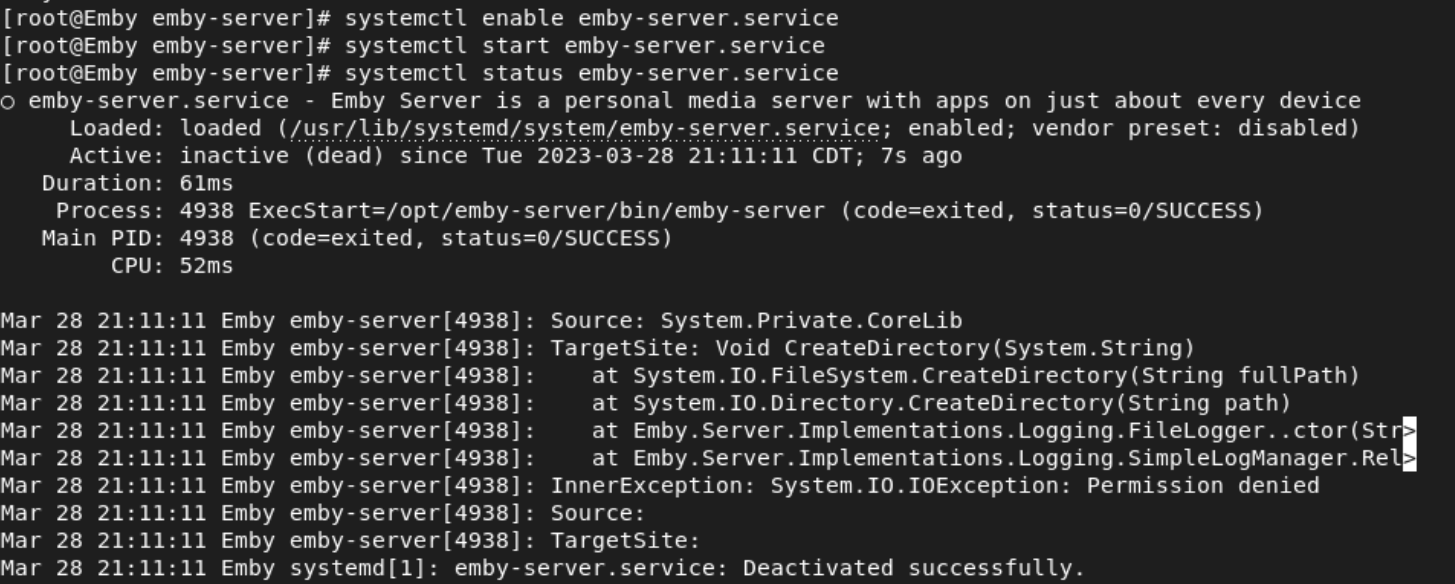

WyattZirbel 16 Posted March 29, 2023 Posted March 29, 2023 On 8/17/2022 at 8:34 AM, Luke said: Thanks for the feedback. I was having this exact same issue. Using the CentOS version on Rocky Linux 9.1 (Rocky is a CentOS clone made by the original CentOS devs. "bug-for bug" they say.) I noticed that /var/lib/emby just didnt exist after installing. I created it and gave it permissions for the correct user and now I'm not having any issues. I ran yum install https://github.com/MediaBrowser/Emby.Releases/releases/download/4.7.11.0/emby-server-rpm_4.7.11.0_x86_64.rpm as Emby Server for Linux - Emby says and got that issue directly after trying to start it. I hope that helps with your bugfixes!!
Luke 42245 Posted March 29, 2023 Posted March 29, 2023 57 minutes ago, WyattZirbel said: I was having this exact same issue. Using the CentOS version on Rocky Linux 9.1 (Rocky is a CentOS clone made by the original CentOS devs. "bug-for bug" they say.) I noticed that /var/lib/emby just didnt exist after installing. I created it and gave it permissions for the correct user and now I'm not having any issues. I ran yum install https://github.com/MediaBrowser/Emby.Releases/releases/download/4.7.11.0/emby-server-rpm_4.7.11.0_x86_64.rpm as Emby Server for Linux - Emby says and got that issue directly after trying to start it. I hope that helps with your bugfixes!! Hi, we'll take a look at it. Thanks. 1
WyattZirbel 16 Posted April 23, 2023 Posted April 23, 2023 On 3/28/2023 at 10:24 PM, Luke said: Hi, we'll take a look at it. Thanks. I ended up needing to reinstall Rocky on that VM and the /var/lib/emby directory created like it was supposed to the first time. I'm not sure I did anything different. 1
