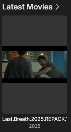

Tank_Killer 7 Posted March 24, 2025 Posted March 24, 2025 (edited) Emby server will detect the new folder/video file but will not scrape the metadata/images from any source. So I am left with just a screenshot from the video file as the poster and the folder name. I can disable nord vpn and kill the app, it will scrape then. Edited March 24, 2025 by Tank_Killer
Luke 42263 Posted March 24, 2025 Posted March 24, 2025 21 minutes ago, Tank_Killer said: Emby server will detect the new folder/video file but will not scrape the metadata/images from any source. So I am left with just a screenshot from the video file as the poster and the folder name. I can disable nord vpn and kill the app, it will scrape then. Hi there, please attach the Emby server log from when the problem occurred: How to Report a Problem Thanks!
Luke 42263 Posted March 24, 2025 Posted March 24, 2025 30 minutes ago, Tank_Killer said: Log embyserver (2).txt 195.6 kB · 0 downloads OK yes so you still have some outgoing requests that are failing that you'll need to look at. You could try disabling ipv6 in your router and see if that helps.
