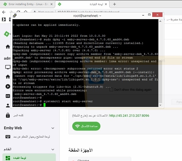

alucryd 318 Posted May 22, 2022 Posted May 22, 2022 Works fine here, the file you downloaded is most likely corrupt, please download again and verify its SHA256 is 07ea727076b758ac2aaf067222da8e06e8f7c6dc87b88d5dc6b4738c78f2ae04.

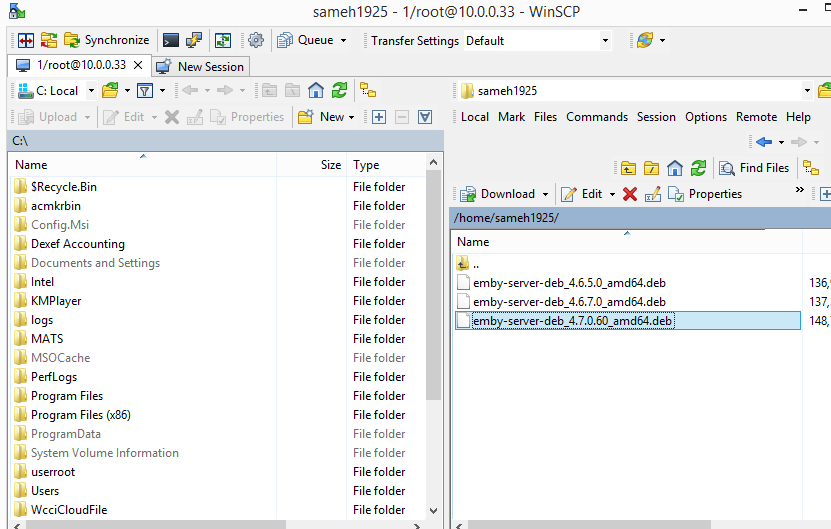

sameh1925 24 Posted May 22, 2022 Author Posted May 22, 2022 I want to update the magazine, which file is suitable for this version?
Luke 42246 Posted May 22, 2022 Posted May 22, 2022 Hi there, what do you mean by magazine? Are you trying to update Emby Server?
Luke 42246 Posted May 22, 2022 Posted May 22, 2022 You just install the latest version on top of your existing version. What platform are you running emby server on?
Luke 42246 Posted May 22, 2022 Posted May 22, 2022 OK so from our linux install page i would follow the Ubuntu X64 instructions: https://emby.media/linux-server.html Please let us know if this helps. Thanks.
sameh1925 24 Posted May 23, 2022 Author Posted May 23, 2022 When updating the Emby server, this error appears ... The file has been downloaded and placed in the Ubuntu version. Then use this command to install sudo dpkg -i emby-server-deb_4.7.0.60_amd64.deb
Luke 42246 Posted May 23, 2022 Posted May 23, 2022 @sameh1925 I've merged your topics that are discussing the same issue. Please try downloading the .deb file again. It looks like you did not download it first.

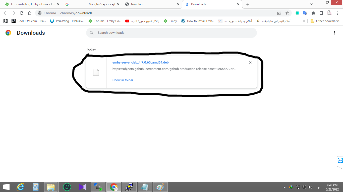

sameh1925 24 Posted May 23, 2022 Author Posted May 23, 2022 I already downloaded the file and put it in its place
sameh1925 24 Posted May 23, 2022 Author Posted May 23, 2022 It was downloaded more than once and in more than one way
Luke 42246 Posted May 31, 2022 Posted May 31, 2022 @sameh1925 can you try downloading the new 4.7.1 release?
