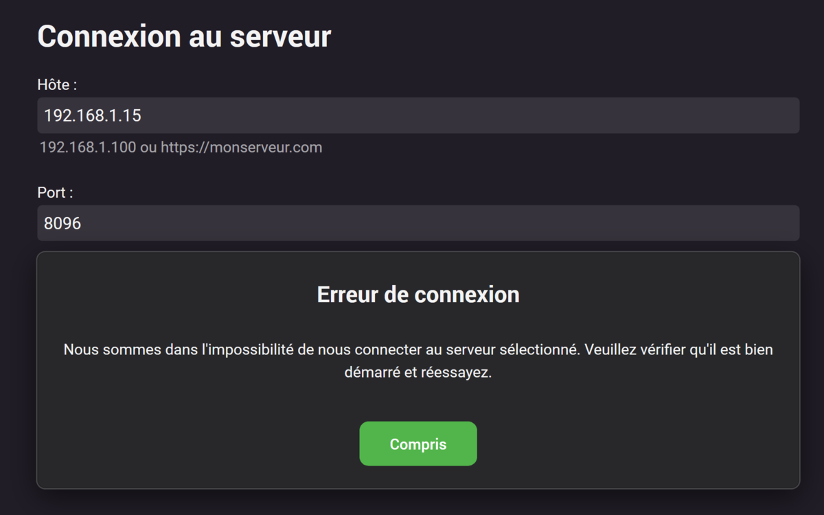

Luke 42180 Posted April 8, 2022 Posted April 8, 2022 Hi, are you sure that is the correct IP address? Is that our web app?
NadineNB 9 Posted April 8, 2022 Author Posted April 8, 2022 (edited) Hello Luke, thank you for the prompt reply! The screenshot shows the Windows 10 app. Yes, it is the correct host entered there, I copied it from the server. I have tried to troubleshoot this for 2h using every single troubleshooting step described here: https://support.emby.media/support/solutions/articles/44001849007-connectivity. Whether I try to connect with the regular new IP address or the Emby server address and port 8096, I get a connection error message. If I enter my Emby Connect login details, the apps (Android and Windows 10) simply reset to the page where it asks to pick a server. I'm very much lost here and no idea how to restore my access to the server on my tablet and laptop (the server is on a Windows tower PC, which I can access and where everything works fine.) Edited April 8, 2022 by NadineNB

NadineNB 9 Posted April 9, 2022 Author Posted April 9, 2022 Update on this: I have logged into my ISP-provided account, to check at a glance how my network is setup. Emby Server is listed as enabled to use UPnP and therefore forwards ports automatically. I have triple checked that the Windows 8.1 PC hosting the Emby server has a static IP address, and that said address is the same as shown in the screen in the first post of the thread. Still getting connection error messages across all my devices (Windows 10 laptop and tablet) and unable to login with LAN and Emby Connect alike.
Luke 42180 Posted April 9, 2022 Posted April 9, 2022 I would probably suggest setting up the ports anyway rather than relying on upnp. Also when you tested earlier with that screenshot, were you inside or outside your home network?
NadineNB 9 Posted April 9, 2022 Author Posted April 9, 2022 45 minutes ago, Luke said: I would probably suggest setting up the ports anyway Could you give me pointers/articles on how to go about that? I believe I have done this but I could be wrong as my native language is french, I will have to check again. And yes for the screenshot, I only use Emby at home.
