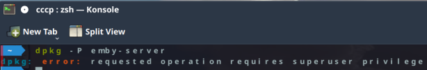

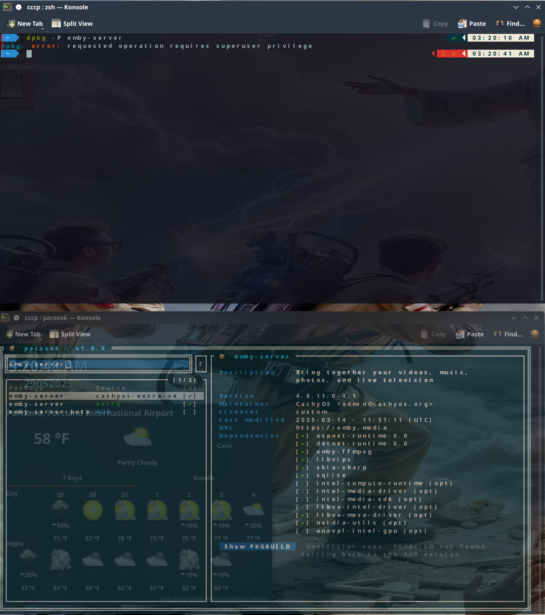

IAmHugh 65 Posted May 29, 2025 Posted May 29, 2025 ~ sudo systemctl stop emby-server ✔ 03:14:02 AM [sudo] password for cccp: ~ sudo systemctl status emby-server ✔ 9s 03:14:47 AM ○ emby-server.service - Emby brings together your videos, music, photos, and live television. Loaded: loaded (/usr/lib/systemd/system/emby-server.service; enabled; preset: disabled) Active: inactive (dead) since Thu 2025-05-29 03:14:47 PDT; 30s ago Duration: 25min 53.390s Invocation: bb5981eae3374de6a3a2d2910d689135 Process: 346842 ExecStart=/usr/bin/emby-server (code=exited, status=0/SUCCESS) Main PID: 346842 (code=exited, status=0/SUCCESS) Mem peak: 175.3M CPU: 4.479s May 29 03:14:46 CCCp emby-server[346842]: Info SqliteUserRepository: PRAGMA analysis_limit=400;PRAGMA o> May 29 03:14:46 CCCp emby-server[346842]: Info SqliteUserRepository: Closing sqlite connection May 29 03:14:46 CCCp emby-server[346842]: Info App: Disposing InstallationManager May 29 03:14:46 CCCp emby-server[346842]: Info App: Disposing TaskManager May 29 03:14:46 CCCp emby-server[346842]: Info App: Disposing MediaMountManager May 29 03:14:46 CCCp emby-server[346842]: Info App: Dispose complete May 29 03:14:47 CCCp emby-server[346842]: Info Main: Shutdown complete May 29 03:14:47 CCCp systemd[1]: emby-server.service: Deactivated successfully. May 29 03:14:47 CCCp systemd[1]: Stopped Emby brings together your videos, music, photos, and live tele> May 29 03:14:47 CCCp systemd[1]: emby-server.service: Consumed 4.479s CPU time, 175.3M memory peak Even though dpkg says Emby isn't installed as you can see from Pacseek emby-server is installed. Uninstalled it, removed the emby folder in /var/lib. .deb file won't install due to needing libc6 which doesn't seem to be available for Arch.
sa2000 703 Posted May 29, 2025 Posted May 29, 2025 (edited) That screenshot shows the "dpkg -P " faing because it requires priviledge to run as root After that error, did you try sudo dpkg -P emby-server Edited May 29, 2025 by sa2000
IAmHugh 65 Posted May 29, 2025 Posted May 29, 2025 OK not sure how I missed running it as root. Rolled back to where the beta works. Think later I just want to try to figure out why the TV app isn't behaving with the beta, but will with the release version in Garuda. Might just be easier to sort the TV app. 2
