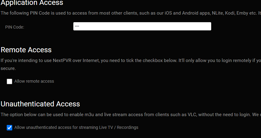

arrbee99 1712 Posted June 21, 2021 Posted June 21, 2021 (edited) My Emby setting are these (similar to Emby Dashboard LAN access) - though no guarantees they should be the same Edited June 21, 2021 by arrbee99

Globalnetwork 0 Posted June 21, 2021 Author Posted June 21, 2021 59 minutes ago, arrbee99 said: My Emby setting are these (similar to Emby Dashboard LAN access) - though no guarantees they should be the same I made the same setup, but the channels did not appear

arrbee99 1712 Posted June 21, 2021 Posted June 21, 2021 4 minutes ago, Globalnetwork said: I made the same setup, but the channels did not appear I could of course just be wrong. I seem to remember it made a difference for me, though that was a few years ago now. You have this in NextPVR ? i.e. you are allowing remote access and your pin (12345) matches your NextPVR pin ? Could also be a matter of maybe restarting Emby server, refreshing the guide (in Emby), giving it some more time...

arrbee99 1712 Posted June 21, 2021 Posted June 21, 2021 You have your ticks opposite to mine. On the Emby Dashboard, there's a section called Paths which includes a Logs location
emveepee 125 Posted June 21, 2021 Posted June 21, 2021 @arrbee99 he will not need remote streaming on localhost., that is specific to really incoming Internet IP addresses. His Unauthenticated access choice is correct for Emby for streaming recordings. Martin
