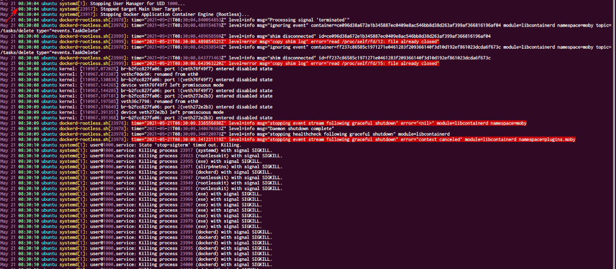

lbrf 0 Posted May 22, 2021 Posted May 22, 2021 (edited) @moisesnfernnade mesmo problema aqui. I tried both latest beta and stable versions here. Even a fresh install, with fresh database/config crashes after some time. Image: ghcr.io/linuxserver/emby One thing strange here is the buff/cache, maybe this is forcing the SO kill the process... I have a premiere account... Edited May 22, 2021 by lbrf

lbrf 0 Posted May 28, 2021 Posted May 28, 2021 @Happy2Play no, i dont. @Lukei'm not with much time available to debug this. But I think it was related to container using all device memory then SO killing the process. I've "fixed" by re-installing docker and using it as root. Container is up for 2 days without any issues. The size of buff/cache still high trough... device: raspberry Pi 4 (4gb) docker-compose.yml Quote emby: image: ghcr.io/linuxserver/emby:beta container_name: emby environment: - PUID=1000 - PGID=1000 - UMASK_SET=022 #optional volumes: - /home/ubuntu/emby:/config - /mnt/transcode:/.transcode ports: - 8822:8096 - 8096:8096 - 8920:8920 #optional devices: - /dev/vchiq:/dev/vchiq # openmax - /dev/video10:/dev/video10 # v4l2 - /dev/video11:/dev/video11 # v4l2 - /dev/video12:/dev/video12 # v4l2 $uname -a Quote Linux ubuntu 5.4.0-1035-raspi #38-Ubuntu SMP PREEMPT Tue Apr 20 21:37:03 UTC 2021 aarch64 aarch64 aarch64 GNU/Linux Docker version 20.10.6, build 370c289 docker-compose version 1.29.2, build unknown
