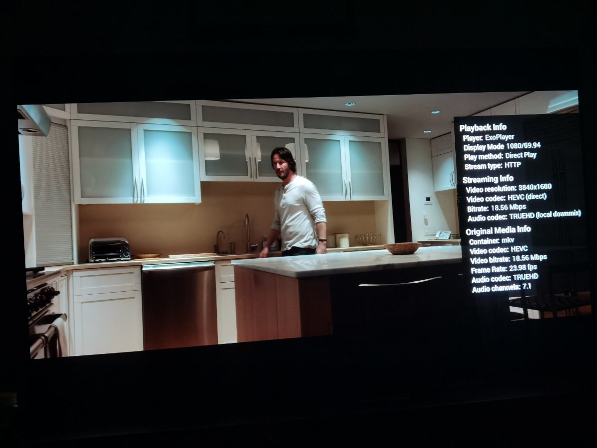

danbas 1 Posted May 6, 2021 Posted May 6, 2021 (edited) 15 hours ago, ebr said: Can we please look at an example of that? Including sending a log from the app (instructions linked above). I've sent a log at 0542 EST time with convert unsupported audio to DD set to disabled (its default state). In stats for nerds it shows direct play error which causes transcoding, essentially making the file unwatchable due to playback issues, major stuttering etc Edited May 6, 2021 by dannyboy1234

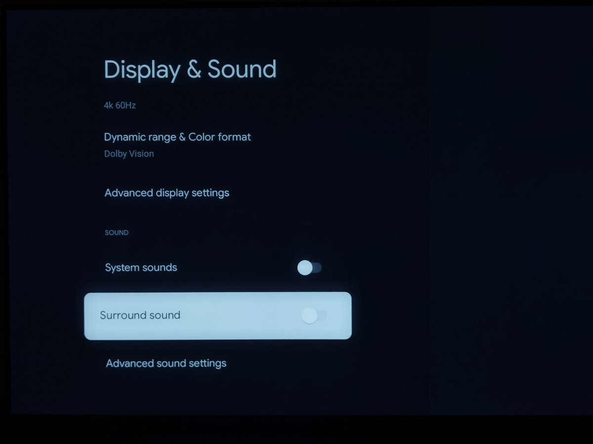

danbas 1 Posted May 6, 2021 Posted May 6, 2021 3 hours ago, ebr said: Instructions are in that same link above. If you go into the audio settings in the Android menus on the Chromecast itself, what is it set to? As I don't administrate the server I don't have access to those logs. I've attached my Chromecast audio setting which is set to auto. Along with before and after shots of the local downmix successfully working and the direct play error on v2

danbas 1 Posted May 6, 2021 Posted May 6, 2021 (edited) 57 minutes ago, ebr said: Yeah, that is what I would expect. So the question is, why is the device reporting support for TrueHD...? If you leave it in manual with those Dolby options turned off, does it play properly? Yes this appears to have fixed it, thanks! With truehd it now shows "(software decode)" in stats for nerds and is playing correctly. But with DTS hd ma, i had to turn off surround sound option in the chromecast settings entirely to get it to play correctly. The previous local downmix option worked with the auto chromecast audio setting and surround sound setting left toggled on. Edited May 6, 2021 by dannyboy1234

danbas 1 Posted May 7, 2021 Posted May 7, 2021 (edited) 8 hours ago, ebr said: What was the state of the DTS checkboxes in the app playback settings? Did you try un-checking those? The DTS check boxes only appear in auto audio mode. With those boxes unchecked DTS and DTS hd ma play fine but this is where I have playback issues with true hd. For my setup the best solution is turning off surround sound. But with the old local downmix option I never had to touch the Chromecast audio settings, leaving surround sound on in auto mode was fine Edited May 7, 2021 by dannyboy1234
