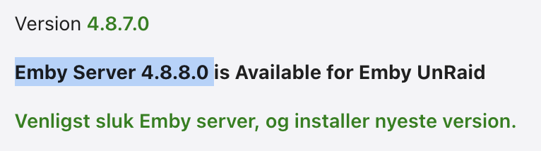

darkassassin07 617 Posted April 23, 2024 Posted April 23, 2024 The one off is great; but I'm looking for a change in your release procedure to include updating docker promptly with each comming update. OR Have docker based emby servers check docker hub for new releases before sending 'update available' notifications. Please stop notifying docker users that an update is available when you have not actually made one available to them. 4
Oracle 84 Posted May 31, 2024 Posted May 31, 2024 On 4/22/2024 at 8:24 PM, darkassassin07 said: Please stop notifying docker users that an update is available when you have not actually made one available to them. Seconding this. @Luke - What is the normal release schedule for Docker container? Can we look into why these are not released at the same time as other release types? Thanks.
Luke 40003 Posted June 4, 2024 Author Posted June 4, 2024 On 5/31/2024 at 10:56 AM, Oracle said: Seconding this. @Luke - What is the normal release schedule for Docker container? Can we look into why these are not released at the same time as other release types? Thanks. HI, apologies, missed this posting. It is the same schedule as other platforms. It's just one of the last to build. In this case it was available the following morning. We'll try and shorten that gap of time. Thanks. 2
Oracle 84 Posted June 5, 2024 Posted June 5, 2024 22 hours ago, Luke said: HI, apologies, missed this posting. It is the same schedule as other platforms. It's just one of the last to build. In this case it was available the following morning. We'll try and shorten that gap of time. Thanks. Thanks, buddy! Appreciate what you and the team do. 1

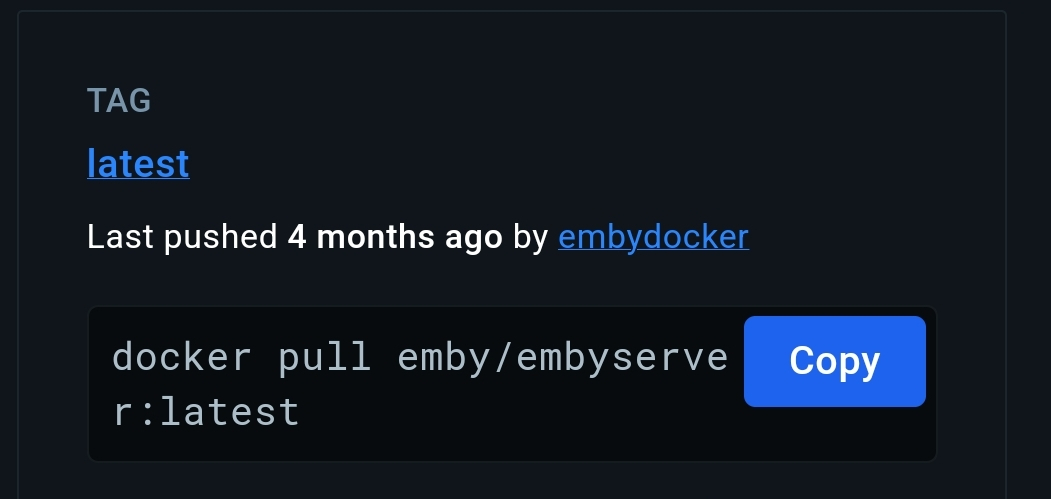

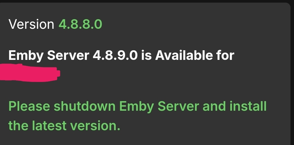

darkassassin07 617 Posted September 26, 2024 Posted September 26, 2024 On 4/22/2024 at 5:24 PM, darkassassin07 said: The one off is great; but I'm looking for a change in your release procedure to include updating docker promptly with each comming update. OR Have docker based emby servers check docker hub for new releases before sending 'update available' notifications. Please stop notifying docker users that an update is available when you have not actually made one available to them. @Luke 1
Luke 40003 Posted September 26, 2024 Author Posted September 26, 2024 4 hours ago, darkassassin07 said: @Luke HI, it should be up in a day or so. Apologies for the delay. 4
