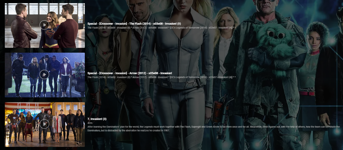

So taking an example - Arrowverse Invasion !  (a 3 way crossover)
The first part of the crossover is 'the Flash' so that appears as it would do normally ... (episode 8 ) ..
.. the script has inserted the two 'crossover' episodes after ep8 - they are named accordingly (Arrow, then DC Legends) and the plot also details all the members of the crossover in order - with the current 'real' member in square brackets.
.. Arrow is next in the crossover, so in that show, it is listing the crossovers as 'the Flash' (before) and DC Legends (after), with the Arrow episode being ep8.
Finally, in the 3rd show - DC legends, it has put the two 'crossover' episodes before the DC legends Ep7.
So it doesn't matter what show you are viewing it from - you always get the correct crossover sequence. 😎
