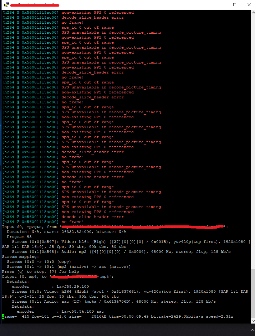

onio 0 Posted April 6, 2021 Author Posted April 6, 2021 2 hours ago, Luke said: Let's look at your example. Please attach the information requested in how to report a problem. thanks. eno2 has udp live stream ethernet on Screenshot (2) udp stream error on live tv Screenshot(1) udp stream checked on ffmpeg Screenshot(3) RTMP and HTTP file working file MN_Royal.m3u8 udp file MNB.m3u attached server log embyserver (3).txt ffmpeg-transcode-7a6946da-c97e-4e50-85e5-b9c2a4fd0d48_1.txt MN_Royal.m3u8 MNB.m3u
Luke 40077 Posted April 6, 2021 Posted April 6, 2021 Ok thanks. The error in your server log is resolved for the next release.
