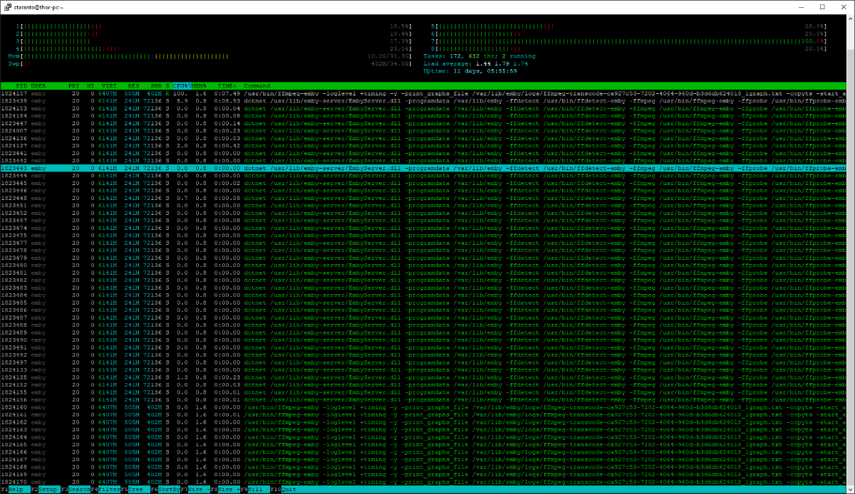

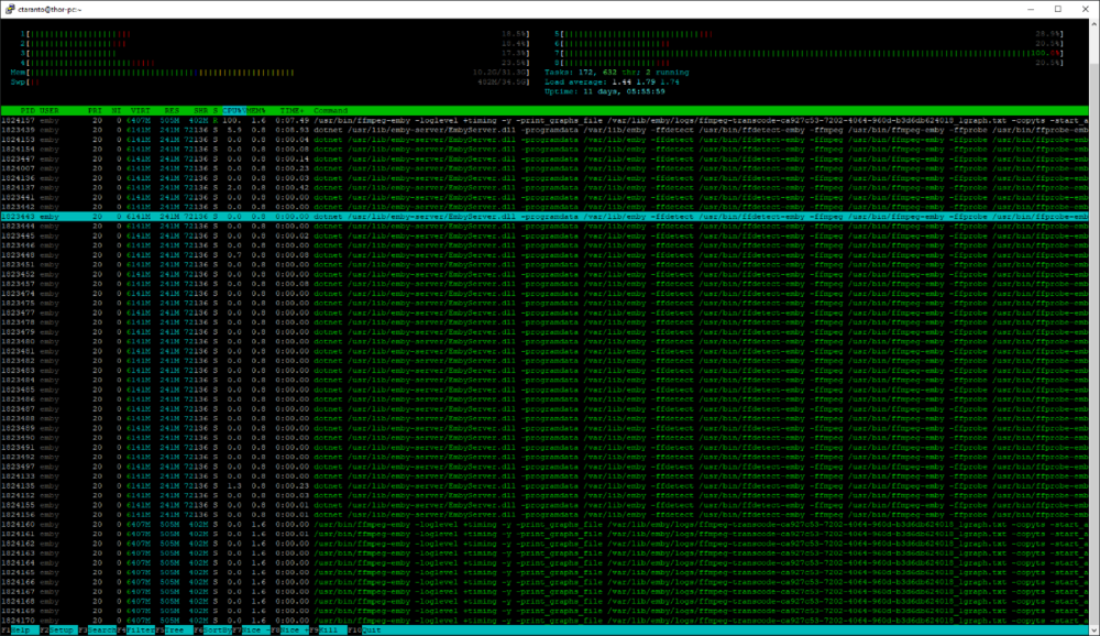

ctaranto 14 Posted February 4, 2021 Posted February 4, 2021 Command line: /usr/lib/emby-server/EmbyServer.dll -programdata /var/lib/emby -ffdetect /usr/bin/ffdetect-emby -ffmpeg /usr/bin/ffmpeg-emby -ffprobe /usr/bin/ffprobe-emby -restartexitcode 3 Operating system: Linux version 5.4.89-1-MANJARO (builduser@LEGION) (gcc version 10.2.0 (GCC)) #1 SMP PREEMPT Tue Jan 12 23:39:44 UTC 2021 Framework: .NET Core 3.1.8 OS/Process: x64/x64 Runtime: usr/share/dotnet/shared/Microsoft.NETCore.App/3.1.8/System.Private.CoreLib.dll Processor count: 8 Data path: /var/lib/emby Application path: /usr/lib/emby-server 32 GB RAM Emby server is configured with GPU Hardware Transcoding (nvidia 1660 Super). It appears to be working great - without GPU HW transcoding, all CPU threads spike to 100% and the content freezes. With GPU HW, a single CPU thread hovers around 70% and content plays great. When I stop a movie, the CPU thread continues to run (attached is the process list). The "white" lines are the main processes. The green lines are threads and can be ignored. The main process (on top) is the CPU process that shouldn't be there, as the client is no longer connected to the server. When transcoding by CPU, the process all stop (though transcoding isn't necessarily successful since my CPU doesn't have enough oomph - i7-4790k overclocked to 4.4Ghz). Restarting the Emby Server makes the process go away. Until I do another HW transcode... Any thoughts on how I can resolve this?

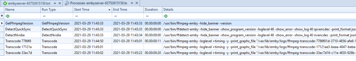

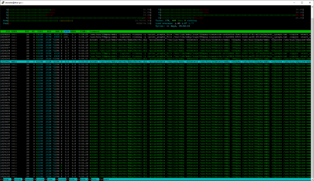

ctaranto 14 Posted March 30, 2021 Author Posted March 30, 2021 (edited) Playing Greenland at 4k (auto bitrate): Changing the bitrate to 1080p / 20Mpbs during playback. Two ffmpegs: Exiting the playing moving using the on-screen back button. One ffmpeg is remaining and never goes away until I restart the Emby server: If you need more files, let me know and I can PM them to you. Edited March 30, 2021 by ctaranto
softworkz 4569 Posted March 30, 2021 Posted March 30, 2021 9 minutes ago, Luke said: How are you determining that? because the log you provided shows the ffmpeg process exiting normally. The server log includes in fact one ffmpeg that hasn't ended (within the time covered by the log)
ctaranto 14 Posted March 30, 2021 Author Posted March 30, 2021 (edited) What I find odd is the UUID of the ffmpeg process changes when I change bit rates. For example, if the ffmpeg uuid when playing content at 4k is 1, and I switch bitrates to 1080p, there are then two ffmpeg process with uuid's 2 and 3. The ffmpeg uuid of 1 is no longer there. When I exit using the on screen back button, ffmpeg process with uuid 3 goes away. That can be seen in the screen shots of htop I posted above, as well as the 3 transcodes that are listed by softworkz. Edited March 30, 2021 by ctaranto
