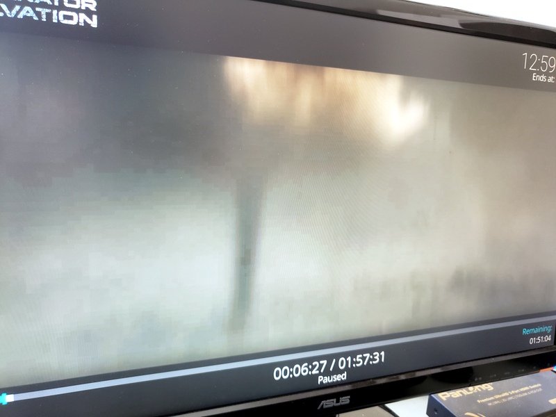

ieblj01 3 Posted January 20, 2021 Posted January 20, 2021 Hello Forum, I am wondering if anyone else is seeing this issue with AFTVs. I have noticed that when watching movies (or TV shows, etc., all different file types, i.e. MP4, MKV) the AFTV will be very pixilated at times (practically unwatchable) and always in the same places of the show/movie. This occurs for files that I have ripped myself at the highest quality which surprises me and this all happens on a local gig network with every device wired in (no wireless). If I watch the same file on a phone or use a Rasberry Pi with LibreElec/Kodi (EmbyCon) connected to the same TV as the AFTV, the picture quality is significantly better and I don't see the pixilation event at all or it is dramatically reduced. Is this just a major difference in how the two clients handle the files when displaying them? I am running the latest version of Emby server (4.5.4) on Ubuntu 20.04. AFTV clients are running Emby 1.8.54a. I attached an example comparison between AFTV and Kodi/EmbyCon at the same point in the same move on a halfway decent monitor (not as clear as my HD TVs) and you can clearly see a difference between them. The system connections are identical (same HDMI cable, monitor port, etc.) I simply switched out the AFTV for the Rasberry Pi.
ebr 15672 Posted January 20, 2021 Posted January 20, 2021 Hi. How is the item playing? That looks like the first one is at a significantly lower bitrate due possibly to transcoding.
ieblj01 3 Posted January 20, 2021 Author Posted January 20, 2021 (edited) You nailed that ebr. it is transcoding when playing off the AFTV and direct playing off the Pi. Seems the AFTV doesn't support the codec. Edited January 20, 2021 by ieblj01 added additional screenshots
ebr 15672 Posted January 20, 2021 Posted January 20, 2021 That actually says we tried to direct play it but there was an error so we fell back to transcoding. The subsequent conversion from mpeg4 to h264 is probably where the quality decrease is coming from. If you can play that item for just a few seconds and then send a log from the app, I can see what error caused the fallback. Thanks.

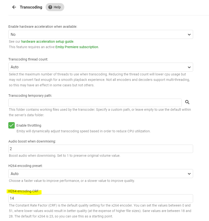

jrwalte 17 Posted January 21, 2021 Posted January 21, 2021 If you have a decent CPU/GPU running your Emby server, you definitely want to reduce the H264 encoding CRF option. I use 14, which keeps the file bitrate near original. 1
ieblj01 3 Posted January 21, 2021 Author Posted January 21, 2021 Thanks, I will give that a try. My server is definitely overpowered

ieblj01 3 Posted January 25, 2021 Author Posted January 25, 2021 1 hour ago, ebr said: Hi. Did you try adjusting any of the advanced transcoding settings? yes I did. in all honestly, it was still terrible picture quality regardless of how I adjusted those, even if I went to extreme values
jrwalte 17 Posted January 26, 2021 Posted January 26, 2021 Was the hardware acceleration on or off by chance? ON can cause poor results when you're attempting high compression. GPU encoding is better for originally high bitrate with low compression. CPU does better with heavy compression.
ieblj01 3 Posted January 26, 2021 Author Posted January 26, 2021 (edited) 17 hours ago, jrwalte said: Was the hardware acceleration on or off by chance? ON can cause poor results when you're attempting high compression. GPU encoding is better for originally high bitrate with low compression. CPU does better with heavy compression. yes, I believe it was on. I will turn it off and see if that helps at all. Edited January 26, 2021 by ieblj01
ieblj01 3 Posted January 26, 2021 Author Posted January 26, 2021 (edited) Turning off hardware acceleration made a huge difference in video quality with the more aggressive compression settings. This comes in handy as I have a couple of first gen AFTVs that don't support hevc (in addition to 2nd gen models that do). The Kodi/Embycon bandaid sidesteps the mpeg transcode issue, but then craps out on hevc files on the 1st models. Hopefully the coding gurus will figure out why the AFTV client is transcoding supported files and this problem will eventually go away Thanks for the insight on the HW acc setting. With the Premiere account it was on by default. Edited January 26, 2021 by ieblj01 Additonal info 1
