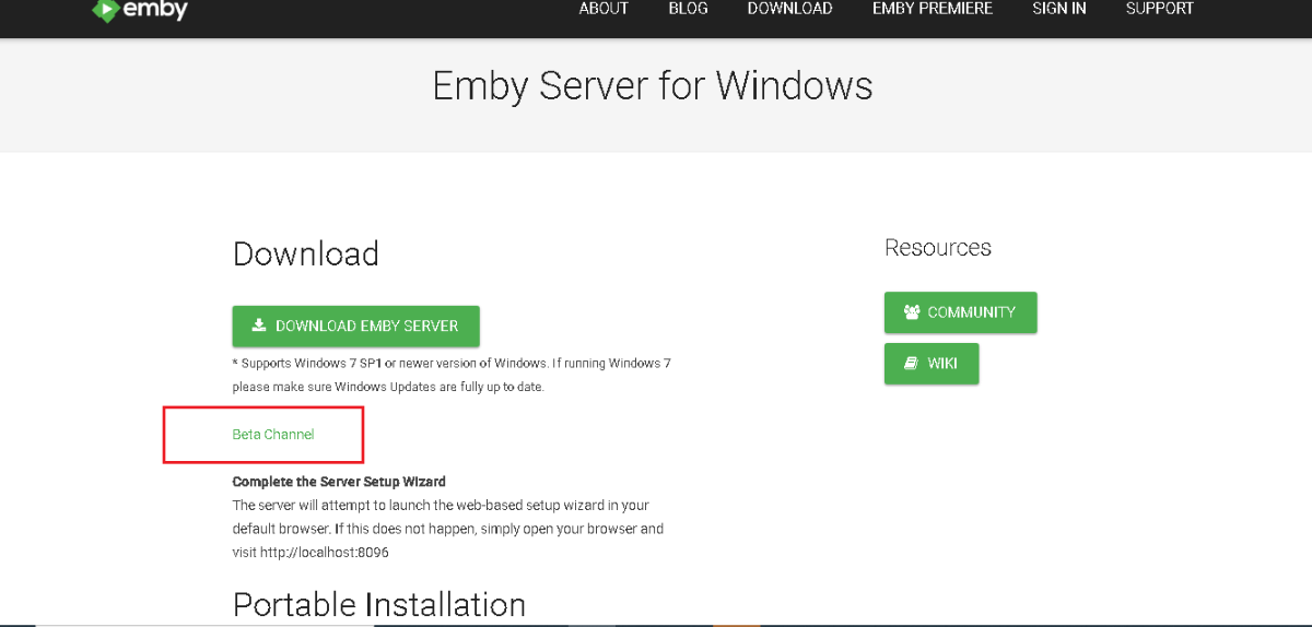

Jason'sEmby 29 Posted January 15, 2021 Posted January 15, 2021 (edited) @ebr I'm jumping ship to you guys. Orange is a lost cause. How do I go about getting on beta and do you possibly have an ETA on the next Beta release that might fix the tuner released? Thank you Edited January 15, 2021 by Jason'sEmby I can test myself;)
Carlo 4552 Posted January 15, 2021 Posted January 15, 2021 You can download the Beta Server and install it from the download page on the website. Once you do this the server will stay updated with the beta releases 1
Jason'sEmby 29 Posted January 15, 2021 Posted January 15, 2021 Thank you I was looking all over the dashboard for it, I'm too trained on Plex. 1
