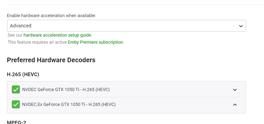

Been using emby a while and love it. On my Archlinux server I host it inside a docker container. However I have just added a Nvidia 1050 GPU to help solve some issue I am having with on the fly stream transcoding.
Emby can see the GPU(s) as they are present here in the transcode options.
But when watching a film...

  • Solution
Hi, I would suggest taking a look at this:
As per your comment in that thread moving to the Beta has solved my issue...
