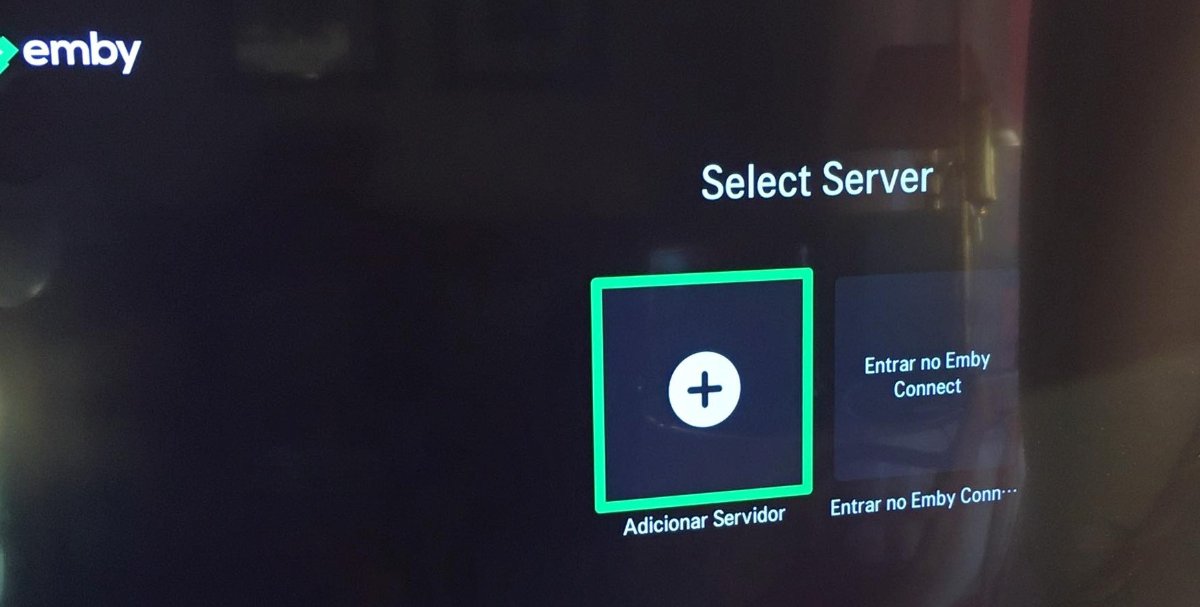

Yes, Emby App (Version 1.0.24) from LG Content Store.
When I start the App, it asks me to go to https://emby.media/pin and enter the code to login which I did.
Than, I select the server.
I put the number of the server and try to connect to it.
But, unfortunatelly, it gives the connection failure that I spoke above.

Ensure your TV has an IP address from the 192.168.1.x network (look in the settings) -
Put the http:\\ in the LG emby client 'Host' box -
ie
Host http:\\192.168.1.87
Port : 8096 (as you did before).
