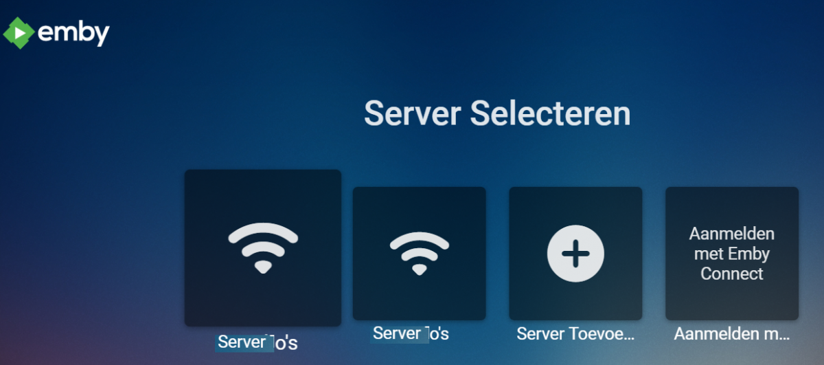

Davey's 19 Posted October 19, 2020 Author Posted October 19, 2020 in the meantime my Emby is still not working, I am disappointed people about the way the support is offered. In the meantime, when selecting the server I have discovered two of the same names, for priv acy reeasons I have called them servero's

Luke 40114 Posted October 19, 2020 Posted October 19, 2020 2 hours ago, Davey's said: in the meantime my Emby is still not working, I am disappointed people about the way the support is offered. In the meantime, when selecting the server I have discovered two of the same names, for priv acy reeasons I have called them servero's That's due to uninstalling then reinstalling. You can simply delete one or both of them and then add it back if needed. What exactly is still not working at this point?
