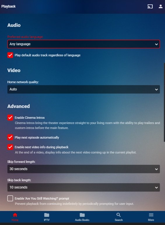

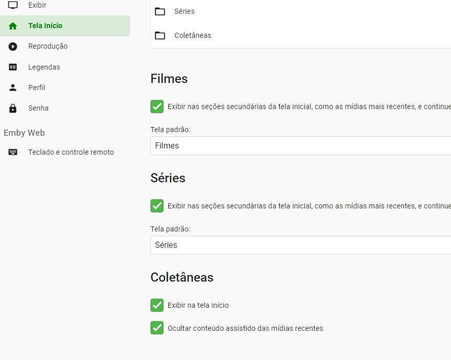

Happy2Play 9446 Posted August 28, 2020 Posted August 28, 2020 (edited) 4 minutes ago, Alexwerilles said: It looks great with this code, everything is red, without having to change one by one. However, in the user settings menu, all green options remain. The options when clicked turn green, instead of red. I don't understand. Even changed theme to Light Edited August 28, 2020 by Happy2Play
Happy2Play 9446 Posted August 28, 2020 Posted August 28, 2020 Okay that footer is in mobile or touch screen mode only so let me set a emulator and see what I come up with.
Alexwerilles 3 Posted August 28, 2020 Author Posted August 28, 2020 Yes, I forgot to say that it is only on the cell phone.
Happy2Play 9446 Posted August 28, 2020 Posted August 28, 2020 Just now, Alexwerilles said: Yes, I forgot to say that it is only on the cell phone. Testing this, can you clear your browser cache and see if you get the same results?
Alexwerilles 3 Posted August 28, 2020 Author Posted August 28, 2020 12 minutes ago, Happy2Play said: Testando isso, você pode limpar o cache do navegador e ver se obtém os mesmos resultados? I cleared the cache and it didn't work. As I understand it, it only works with an administrator account. In an ordinary user account, those parts remain green. But there's no problem. How can I remove some options from the settings menu (display, home, etc.) leaving only a few and adding other options? Is there a possibility? (only for non-admin users)

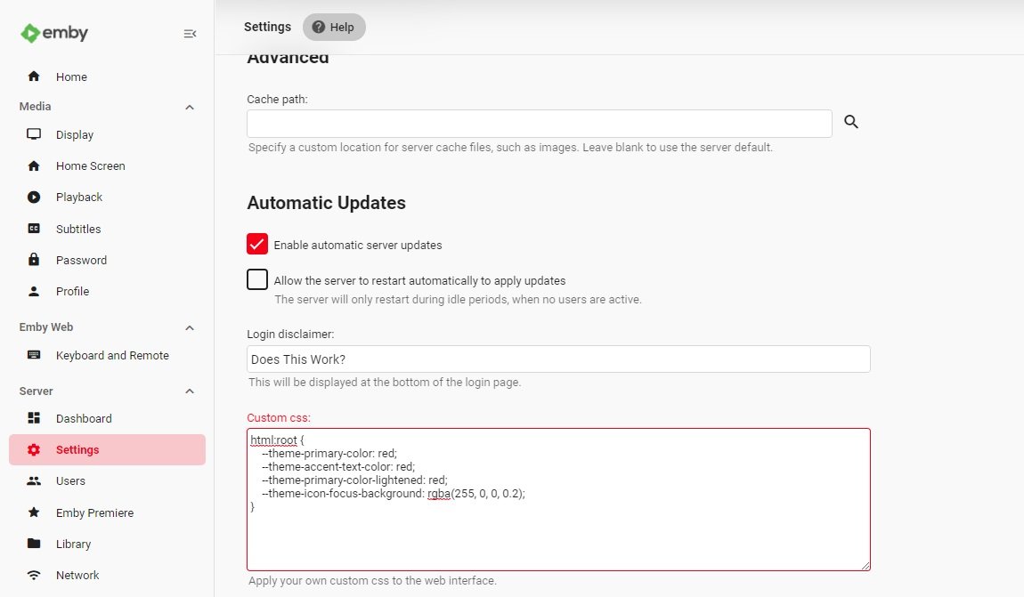

arrbee99 1712 Posted August 28, 2020 Posted August 28, 2020 Can I just ask - this html stuff is just pasted into the css box or its more complicated than that ?
Happy2Play 9446 Posted August 28, 2020 Posted August 28, 2020 1 minute ago, arrbee99 said: Can I just ask - this html stuff is just pasted into the css box or its more complicated than that ? Since the elements are using theme based code starting in 4.5 you can change all element using that theme code as I posted above. So you could change all colors with just those lines. Just have to ensure you remove all current code. Have not test on which code will override the other yet. 1

arrbee99 1712 Posted August 28, 2020 Posted August 28, 2020 16 minutes ago, Happy2Play said: Since the elements are using theme based code starting in 4.5 you can change all element using that theme code as I posted above. So you could change all colors with just those lines. Just have to ensure you remove all current code. Have not test on which code will override the other yet. Thanks. Sounds promising. I assume remove all current code means remove all current code that applies to colours...

Happy2Play 9446 Posted August 28, 2020 Posted August 28, 2020 (edited) 26 minutes ago, arrbee99 said: Thanks. Sounds promising. I assume remove all current code means remove all current code that applies to colours... Correct, easiest way to test is to have a beta test machine and just try the code snippet mentioned above. Like now those 5 lines of code would replace over 40+ lines required in this topic. Edited August 28, 2020 by Happy2Play 1
Alexwerilles 3 Posted August 28, 2020 Author Posted August 28, 2020 32 minutes ago, Happy2Play said: You can remove them but it apply to everyone. As for custom it is hard to say, but probably edited the html. yes, there is no problem deleting for everyone. Can you tell me which file?
Happy2Play 9446 Posted August 28, 2020 Posted August 28, 2020 1 minute ago, Alexwerilles said: yes, there is no problem deleting for everyone. Can you tell me which file? Can you show a screenshot so I am sure we are talking about the same screen.
Alexwerilles 3 Posted August 28, 2020 Author Posted August 28, 2020 8 minutes ago, Happy2Play said: Você pode mostrar uma captura de tela, então tenho certeza que estamos falando da mesma tela. "display" and "home", these two buttons If could replace it, put a button redirecting to a link, it would be great is this the correct code to remove "Emby Web"? Quote div.dynamicRoutes h3:nth-child(7) {display: none;} /*Remove "Emby Web header" on User icon screen*/ div.dynamicRoutes h3:nth-child(9) {display: none;} /*Remove "Emby Web header" on User icon screen*/
arrbee99 1712 Posted August 28, 2020 Posted August 28, 2020 That html thing is working well so far. The only thing it doesn't change is the green 'Emby server is up to date' tick box.
arrbee99 1712 Posted August 28, 2020 Posted August 28, 2020 Think I prefer blue - html:root { --theme-primary-color: #5d7e9b; --theme-accent-text-color: #5d7e9b; --theme-primary-color-lightened: #5d7e9b; --theme-icon-focus-background: rgba(0, 0, 255, 0.2); }
Happy2Play 9446 Posted August 28, 2020 Posted August 28, 2020 2 minutes ago, Alexwerilles said: "display" and "home", these two buttons a[title="Display"], a[title="Home Screen"] {display: none !important;} 6 minutes ago, Alexwerilles said: is this the correct code to remove "Emby Web"? Quote div.dynamicRoutes h3:nth-child(7) {display: none;} /*Remove "Emby Web header" on User icon screen*/ div.dynamicRoutes h3:nth-child(9) {display: none;} /*Remove "Emby Web header" on User icon screen*/ Yes as it will cover the user "Allow this user to change their password and profile image" setting enabled or disabled. 9 minutes ago, Alexwerilles said: If could replace it, put a button redirecting to a link, it would be great Here is a quick addition to the user icon settings page, still haven't figure out the maindrawer. Similar to here quick and dirty add to settings.html Quote <div is="emby-scroller" class="view flex flex-direction-column scrollFrameY flex-grow" data-mousewheel="true" data-horizontal="false" data-centerfocus="card"> <div class="scrollSlider flex-grow flex-direction-column padded-left padded-right padded-top-page padded-bottom-page settingsContainer"> <div class="readOnlyContent" style="margin: 0 auto;"> <a is="emby-linkbutton" class="raised emby-button" href="https://github.com/MediaBrowser" target="_blank" style="padding-left: 0;">${LinkGithub}</a> <div class="dynamicRoutes"> </div> <p class="appInfo secondaryText" style="text-align:center;"></p> </div> </div> </div>
Happy2Play 9446 Posted August 29, 2020 Posted August 29, 2020 16 minutes ago, arrbee99 said: That html thing is working well so far. The only thing it doesn't change is the green 'Emby server is up to date' tick box. Yep this one requires its own code, but still a lot less code to worry about. 1
Alexwerilles 3 Posted August 29, 2020 Author Posted August 29, 2020 18 hours ago, Happy2Play said: Yes as it will cover the user "Allow this user to change their password and profile image" setting enabled or disabled. It keeps showing up here, I don't know why
Happy2Play 9446 Posted August 29, 2020 Posted August 29, 2020 5 minutes ago, Alexwerilles said: It keeps showing up here, I don't know why That is not the same location. One is on the user settings page that is a docked drawer menu. div.mainDrawer.scrollY.scrollY-mini.mainDrawer-open-full.mainDrawer-docked h3:nth-child(8) {display: none;}
