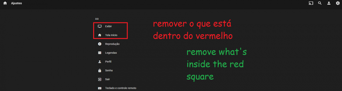

igeoorge 26 Posted August 19, 2020 Posted August 19, 2020 Hi friends, These two codes: / * ---- Remove Sub-Menu ---- * / .itemsViewSettingsContainer .btnFilter, .itemsViewSettingsContainer .btnViewSettings {display: none;} / * ---- Remove selection from the menu and emby the menu ---- * / div.dynamicRoutes h3: nth-child (9) {display: none;} div.mainDrawer-docked a: nth-child (-n + 3) {display: none! important;} div.mainDrawer-docked h3: nth-child (8) {display: none;} They are no longer working in beta version 4.5.20. See attached images. can you help me?
Happy2Play 9441 Posted August 19, 2020 Posted August 19, 2020 (edited) The header option in Movies/Filmes would affect all other content type headers also as discussed in other topics. You would have to modify the specific js file. May need a translation, but is the second image User Settings (user icon). Display and Home Screen? Would appear that "navMenuOption" is set to display !important. div.dynamicRoutes a[title="Display"], div.dynamicRoutes a[title="Home Screen"] {display: none !important;} This affect the admin from getting to these options also if needed. Don't remember what this code was removing but what you have posted has a lot of additional spacing in comments and in the code that breaks the code. /*----Remove Sub-Menu----*/ .itemsViewSettingsContainer .btnFilter, .itemsViewSettingsContainer .btnViewSettings {display: none;} /*Per Library Filter and 3 dot menu buttons*/ /*----Remove selection from the menu and emby the menu----*/ div.dynamicRoutes h3:nth-child(9) {display: none;} /*Remove "Emby Web header" on User icon screen*/ div.mainDrawer-docked a:nth-child(-n + 3) {display: none !important;} /*Remove "Display and Home Screen" on dashboard*/ div.mainDrawer-docked h3:nth-child(8) {display: none;} /*Remove "Emby Web" header on dashboard*/ commented each code and verified working Looks like this code goes to these topics. https://emby.media/community/index.php?/topic/85069-help-with-css/&do=findComment&comment=871426 "Remove selection from the menu and emby the menu" Still looking for the other. Edited August 19, 2020 by Happy2Play 1

igeoorge 26 Posted August 19, 2020 Author Posted August 19, 2020 Hi @Happy2Play Could you help me remove the emby web name here in the profile?
Happy2Play 9441 Posted August 19, 2020 Posted August 19, 2020 50 minutes ago, igeoorge said: Hi @Happy2Play Could you help me remove the emby web name here in the profile? The above code does that. Same with using your css.txt div.dynamicRoutes h3:nth-child(9) {display: none;} /*Remove "Emby Web header" on User icon screen*/ But i think I see what is happening as it is tied to the Users "Allow this user to change their password and profile image" option so it changes the h3:nth-child value as it automatically adds/removes Password and Profile from User. So I guess you would use both to cover if you have the option enabled or disable. So 7 if disabled and 9 if enabled div.dynamicRoutes h3:nth-child(7) {display: none;} /*Remove "Emby Web header" on User icon screen*/ div.dynamicRoutes h3:nth-child(9) {display: none;} /*Remove "Emby Web header" on User icon screen*/ 1
igeoorge 26 Posted August 20, 2020 Author Posted August 20, 2020 Using both, it worked as I wanted. Thank you very much
