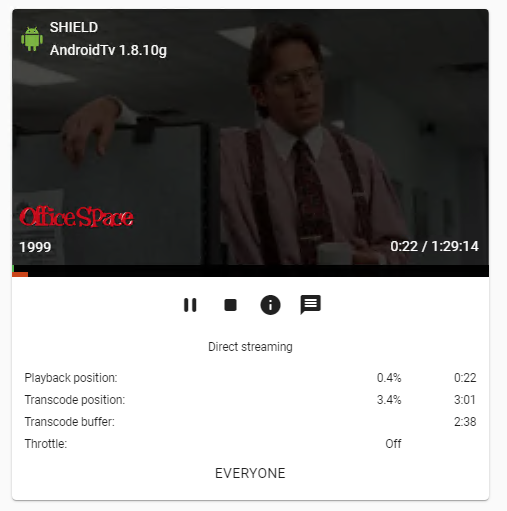

Carlo 4552 Posted August 1, 2020 Posted August 1, 2020 That is about as good as it gets device wise. Really the only way to do better is with an HTTP setup but that still doesn't mean files won't transcode. Transcoding can take place for reasons other then the file itself, like bandwidth. What's the reason for the transcode as Luke asked. Here is one way you can tell from the DASHBOARD view in web admin. Click the "i" that's in the red box below for the trancode reason.

Cydios 3 Posted August 1, 2020 Author Posted August 1, 2020 9 minutes ago, Luke said: You're using an strm file pointing to an mkv? Just saw that and no. That was the screenshot from Kodi, but maybe that's rename for the temp transcode file? Looking at what it's transcoding appears to be the audio. The movie is 6.1 and it's converting to 5.1. There's no other audio options for it. My 7.1 ones play fine. Receiver is 6.1 compatible. I wonder if the shield supports it.

Carlo 4552 Posted August 1, 2020 Posted August 1, 2020 27 minutes ago, Cydios said: Also oddly, it stops transcoding after about 2-3 mins and the movie just stops. Did you mean direct streaming like in the pic you posted above or was it actually transcoding and said that? Just wondering if you switched devices in testing as that changes things a lot.
Cydios 3 Posted August 1, 2020 Author Posted August 1, 2020 (edited) 1 hour ago, cayars said: Did you mean direct streaming like in the pic you posted above or was it actually transcoding and said that? Just wondering if you switched devices in testing as that changes things a lot. Nope, didn't switch.. just stopped coding and the as if I hit the stop button, the server registers it as stopped. Edited August 1, 2020 by Cydios
Carlo 4552 Posted August 1, 2020 Posted August 1, 2020 What I meant was when playing looking at the DASHBOARD does it say TRANSCODING or DIRECT STREAMING?

Cydios 3 Posted August 1, 2020 Author Posted August 1, 2020 37 minutes ago, cayars said: What I meant was when playing looking at the DASHBOARD does it say TRANSCODING or DIRECT STREAMING? Transcoding.
Carlo 4552 Posted August 1, 2020 Posted August 1, 2020 Are you uploading the wrong picture? You're typing Transcoding but the picture says Direct Streaming Don't look at the part I crossed off on the left but look at what is in the yellow section. We should probably change the wording on the left side to remove "transcode" from that.

Carlo 4552 Posted August 1, 2020 Posted August 1, 2020 If you click the "i" icon on that screen above what is the reason for the Direct Stream?
Cydios 3 Posted August 1, 2020 Author Posted August 1, 2020 1 minute ago, cayars said: Are you uploading the wrong picture? You're typing Transcoding but the picture says Direct Streaming Don't look at the part I crossed off on the left but look at what is in the yellow section. We should probably change the wording on the left side to remove "transcode" from that. No. lol. I noticed it too, that's why I posted the screenshot. I was going to type it out, but I thought the picture would help better.
Happy2Play 9458 Posted August 1, 2020 Posted August 1, 2020 (edited) Ideally we have to figure out why your are getting "&TranscodeReasons=DirectPlayError" As this direct stream is converting audio. 16:23:37.477 Stream mapping: 16:23:37.477 Stream #0:0 -> #0:0 (copy) 16:23:37.477 Stream #0:1 -> #0:1 (dts (dca) -> ac3 (native)) Edited August 1, 2020 by Happy2Play
Cydios 3 Posted August 1, 2020 Author Posted August 1, 2020 5 minutes ago, cayars said: If you click the "i" icon on that screen above what is the reason for the Direct Stream?
Cydios 3 Posted August 1, 2020 Author Posted August 1, 2020 2 minutes ago, Happy2Play said: Ideally we have to figure out by your are getting "&TranscodeReasons=DirectPlayError" As this direct stream is converting audio. 16:23:37.477 Stream mapping: 16:23:37.477 Stream #0:0 -> #0:0 (copy) 16:23:37.477 Stream #0:1 -> #0:1 (dts (dca) -> ac3 (native)) It's happening on 3 movies it appears. So it's converting dts to ac3? Isn't the shield dts?
Carlo 4552 Posted August 1, 2020 Posted August 1, 2020 We should improve the message being given when the info button is used as that message is actually wrong. What type of sound system do you have connect to the Shield TV? Does it play DTS? Is the HDMI from the Shield TV going into the TV or a sound system? If going to the TV how is your sound system connected to the TV?
