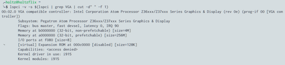

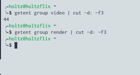

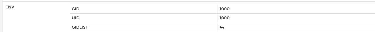

As I have the same problems I decided to take advantage of this topic.
I have a J1800 where it supports QSV and I even use it on Plex.
When checking the transcoder options I realized that it was not being identified.
After realizing that I needed to change the GIDLIST values.
According to the images, I managed to activate it but I don't know if anything else is missing.
Do I need to change anything else?

Based on the screenshots it looks like you're good to go, no?
It seems to me that everything is working well, I was just in doubt about the group render relationship that did not return value and the transcoder appears as VAAPI and not QSV, is this correct? Should I see the QSV together in the options?
  • 2 weeks later...
Docker is currently vaapi only for intel but we may add QSV in future updates. Thanks.
