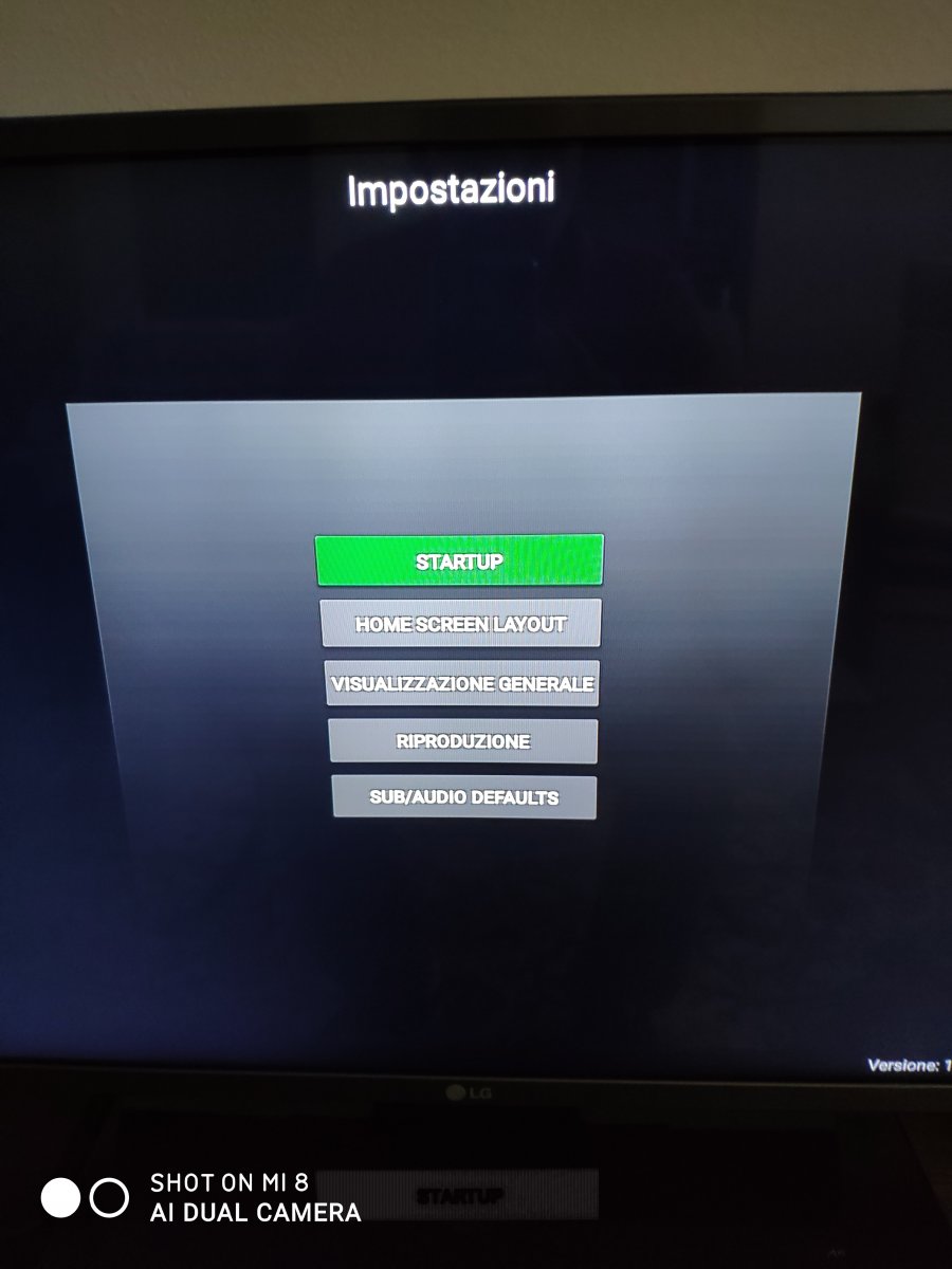

traderman 4 Posted July 14, 2020 Posted July 14, 2020 On 6/4/2020 at 7:36 PM, ebr said: On the user selection screen, there should be a "send logs" button. Can you cause the crash, then immediately restart the app and send the log from that screen? Then come back here and tell me when you did that. Thanks. the same problem too. sent log right now APP version 1.8.10.g Emby for Android TV i tried with EMBY app for Android, but when i launch it, i I go back to the main screen..it does not open my android box is attached
ebr 15679 Posted July 14, 2020 Posted July 14, 2020 6 hours ago, traderman said: the same problem too. sent log right now APP version 1.8.10.g Emby for Android TV i tried with EMBY app for Android, but when i launch it, i I go back to the main screen..it does not open my android box is attached That doesn't look like an Android TV box but what, exactly, is happening for you? I don't see any evidence of a crash in your log.
Carlo 4552 Posted July 14, 2020 Posted July 14, 2020 It might be this box or similar https://www.amazon.com/-/es/Android-Topsion-RK3318-Quad-Core-Bluetooth/dp/B07WZVJYW6
traderman 4 Posted July 14, 2020 Posted July 14, 2020 25 minutes ago, cayars said: It might be this box or similar https://www.amazon.com/-/es/Android-Topsion-RK3318-Quad-Core-Bluetooth/dp/B07WZVJYW6 very similar but android 10
traderman 4 Posted July 14, 2020 Posted July 14, 2020 (edited) 1 hour ago, ebr said: That doesn't look like an Android TV box but what, exactly, is happening for you? I don't see any evidence of a crash in your log. Maybe log is not correct; when i try to play movie this is what happen (see pictures): after error (last picture), i come back to the first picture when i play the same movie on emby for LG all is working fine (a bit of effort when I activate subtitles (.srt)). when i play the same movie on my MI8 xiaomi with Emby all is working fine. Edited July 14, 2020 by traderman
ebr 15679 Posted July 14, 2020 Posted July 14, 2020 Okay, that isn't crashing it just isn't able to play back this item. My guess would be the box is missing some required codec but please send an app log right after you do the above. Thanks.
traderman 4 Posted July 14, 2020 Posted July 14, 2020 (edited) 7 minutes ago, ebr said: Okay, that isn't crashing it just isn't able to play back this item. My guess would be the box is missing some required codec but please send an app log right after you do the above. Thanks. done now I hope you can read something. in order to enable it, I have to exit and re-enter emby is there a way to export the log via usb? Edited July 14, 2020 by traderman
ebr 15679 Posted July 14, 2020 Posted July 14, 2020 I cannot see any playback in your log. Did you try to play that item and then just back to the app home screen and send the log from there?
traderman 4 Posted July 14, 2020 Posted July 14, 2020 (edited) 2 minutes ago, ebr said: I cannot see any playback in your log. Did you try to play that item and then just back to the app home screen and send the log from there? exactly..but to do this i have exit and enter again from Emby. if i don't do this i can't see log Edited July 14, 2020 by traderman
ebr 15679 Posted July 14, 2020 Posted July 14, 2020 Just now, traderman said: but to do this i have exit and enter again from Emby Why?
traderman 4 Posted July 14, 2020 Posted July 14, 2020 (edited) 6 minutes ago, ebr said: Why? try now..but i am not sure.. Edited July 14, 2020 by traderman
