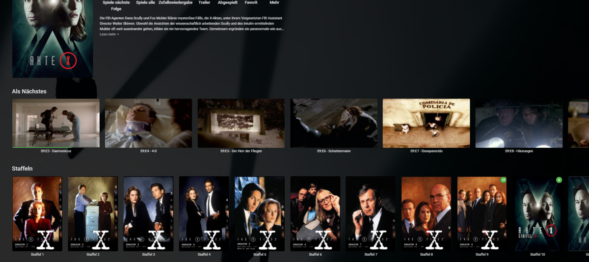

ok, dirty quick test, raised the value in emby settings to 9999, but looks like 50 is the limit.
sample in attachements, x-Files, i have all seasons with all episode, kodi addon syncs up to season 3, episode 1 (50 shows, season 1 24, season 2 25, ...)
then the print  from emby page where u see all seasons are active
in kodi it doesnt show empty folders for seasons even with the feature (show empty seasons) which is as expected ...
so overall, for a show, it stops after the setted value (max 50, nvm what u put there as greater value, see attachement) and moves forward to next show instead stay in show ...
