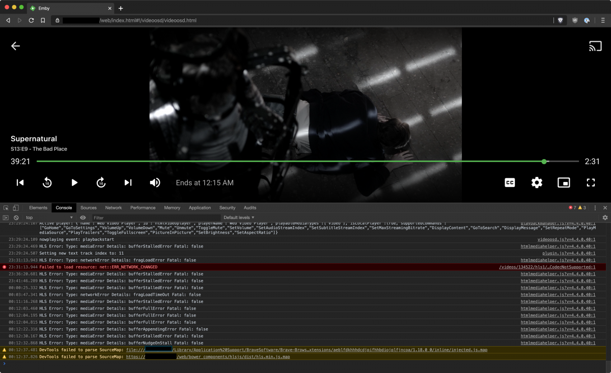

aplusm 1 Posted April 4, 2020 Posted April 4, 2020 (edited) I just encountered this error just now, and managed to grab a screenshot, as well as the full browser console logs. See attached below. System Info:- Browser: Brave v1.15.15 (Chromium-based browser)-- Only active extension for Emby app is 1Password. I disabled any uBlock Origin & Brave Shield (adblockers) when I started encountering these issues.- OS: macOS 10.15.4- Hardware: Macbook Pro 13-inch (Retina, Early 2015) Here's exactly how it unfolded:I was watching Supernatural S13E09, and at minute 39:31.. the playback suddenly stopped. When I hovered to check, the play button was toggled (as if it got paused). I immediately grabbed a screenshot, and copied the full log which should show the log since I opened the web app.At the timestamps where the playback stopped (towards end of the log), I can see those "bufferStalledError" and "bufferFullError" errors I captured before.. and when I tried to press 'play' again, to try to see if it will resume.. I got the 'uncaught promise DOM exception' error that @@ezzah posted. The playback never resumed obviously, regardless of how long I wait. emby_console_masked.txt Edited April 4, 2020 by aplusm 1

aplusm 1 Posted April 6, 2020 Posted April 6, 2020 (edited) I just wanted to clarify on the browser part. I encountered this problem on BOTH Safari and Brave, not exclusively Brave. You'll see in my post #3 that the screenshot of a similar error in the console, is in the Safari Console viewer. So the problem (and the exact error) I encountered was on both Safari and Brave.. I just happened to be using Brave when it happened again, and managed to get you the full logs I'm using the latest Safari 13.1 on macOS 10.15.4 Catalina FYI I have started using Firefox today, and will see if I encounter it on Firefox as well. Edited April 6, 2020 by aplusm
