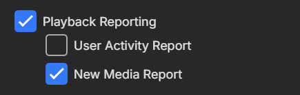

seanbuff 1146 Posted August 13, 2024 Posted August 13, 2024 21 minutes ago, HairyBizRat said: anything I have overlooked? Can you show us how your Notification is set up? Sounds like you may have configured the core 'New Media Added' notification (which is triggered immediately), and not the one specific to 'Playback Reporting' (which follows the scheduled task you are referring to) This is the one you need to select:
