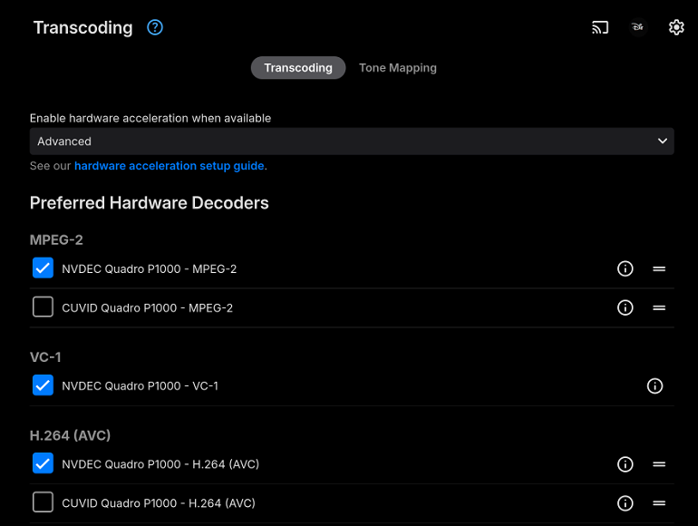

Seion 0 Posted June 23, 2023 Posted June 23, 2023 I am not able to get it to use Hardware Transcoding. Every time I play a video that is transcoding, its using cpu I made sure I did all of the steps above that quorn23 posted above. In Emby it can see my card I had this when I ran docker compose deploy: resources: reservations: devices: - driver: nvidia count: 1 capabilities: [gpu]
Seion 0 Posted June 23, 2023 Posted June 23, 2023 Ignore the above post, I missed the part where premium is required for hardware acceleration...
Nuitarius 22 Posted July 5, 2024 Posted July 5, 2024 (edited) Hi, I am having trouble with getting my linux/docker setup running with gpu all property. I bought a Quadro card and want to use it for hardware acceleration. I am getting this feedback every time: sudo docker run -d --volume /mnt/Disk1/EmbyServer/config:/config --volume /mnt/Disk1:/mnt/Disk1 --volume /mnt/Disk2:/mnt/Disk2 --volume /mnt/Disk3:/mnt/Disk3 --restart unless-stopped --gpus all --publish 8096:8096 --publish 8920:8920 --env UID=2 --env GID=2 --env GIDLIST=2 --name embyserv emby/embyserver:latest 50bb0ee1df8892376c3dd24a491ec88f7ddeec549abd55d4c6a557d2c88fc15b docker: Error response from daemon: failed to create task for container: failed to create shim task: OCI runtime create failed: runc create failed: unable to start container process: error during container init: error running hook #0: error running hook: exit status 1, stdout: , stderr: Auto-detected mode as 'legacy' nvidia-container-cli: initialization error: load library failed: libnvidia-ml.so.1: cannot open shared object file: no such file or directory: unknown. I have been following this forum and nvidias installation guide and several other sites in an effort to figure out what is going on with no luck. I am completely uninstalling docker every time in an effort to get this running, but alas nothing. My old docker run command without the --gpu all is still working. I hope someone can help me out. I am no linux wizard, so be gentle Edited July 5, 2024 by Nuitarius
