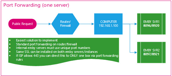

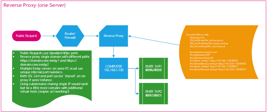

mouseware 9 Posted July 31, 2019 Posted July 31, 2019 If you just HAD to have two servers running on same box, then you could do this several ways. Again, assuming both emby instances were on same computer, and both had unique port numbers set, you could just port forward: If you wanted cleaner end user experience then you can reverse proxy this: You don't need two NICs for this, especially if they are on the same LAN. If different lans or vlans, i would need to try and understand why it's setup this way, and why you'd be hosting both on same box. 1
