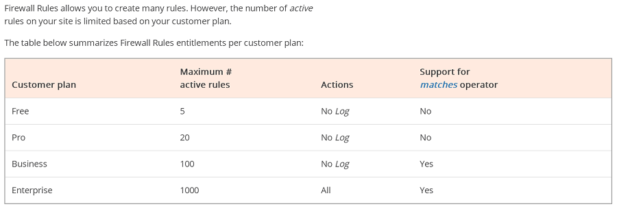

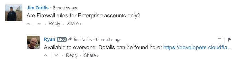

Senna 368 Posted April 5, 2019 Posted April 5, 2019 Being able to block with the firewall rules by country is a 'bug' currently that shouldn't be available to the free plans. They could yank it at any time. https://community.cloudflare.com/t/firewallaccessrules-api-not-entitled-country-block-code-10016/28475/4 John Your information is superseded, because of new Cloudflare policy regarding Firewall rules: https://blog.cloudflare.com/announcing-firewall-rules/ This is the official Cloudflare FAQ now, how many rules you can use with each plan:
jad3675 26 Posted April 5, 2019 Author Posted April 5, 2019 (edited) Your information is superseded, because of new Cloudflare policy regarding Firewall rules: https://blog.cloudflare.com/announcing-firewall-rules/ This is the official Cloudflare FAQ now, how many rules you can use with each plan: Fair enough, but I *think* the ability to block by country isn't meant for the free plans and it may revert to 'challenge' at some point. Regardless, as long as it works it's a great feature to use. John Edited April 5, 2019 by jad3675
