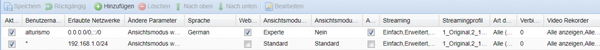

alturismo 37 Posted March 26, 2019 Posted March 26, 2019 (edited) add a proper user without credentials or use your credentials sample http://username:password@192.168.1.2:9981/playlist/channels.m3u of course replace the ip ... or as mentioned above, add a user * see attachement, i added a * user with no password for LAN access only ... Edited March 26, 2019 by alturismo 1
Guest Posted March 26, 2019 Posted March 26, 2019 add a proper user without credentials or use your credentials sample http://username:password@192.168.1.2:9981/playlist/channels.m3u of course replace the ip ... or as mentioned above, add a user * see attachement, i added a * user with no password for LAN access only ... Thanks a lot. Now it's working!

alturismo 37 Posted March 29, 2019 Posted March 29, 2019 may try changing the auth method, see attachement

alturismo 37 Posted March 29, 2019 Posted March 29, 2019 hmm, its been a while since i setted up my tvheadend, but when i remember it was working here ... i once saw this behavior on libreelec tvheadend ... but then i left it blank, finished setup, added my user and deleted the * user. as you see above i have a admin user external AND my LAN user (just to simplify), i also could use the user:pass schema, but makes it more complicated to always enter user credentials for loacal mashines ... and yes, theres a learning curve with tvheadend, but in the end ... you have a perfect tv backend, like u described also with several input sources for 1 channel (here as sample DVB-C and DVB-S). 1
