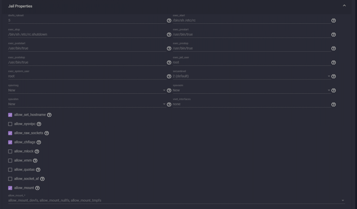

Baenwort 108 Posted November 10, 2020 Posted November 10, 2020 7 hours ago, Duffyx said: You need to create a new devfs ruleset that exposes the /dev/dri and /dev/drm of the host in the jail. [devfsrules_drm=10] add include $devfsrules_jail add path dri unhide add path dri/* unhide add path drm unhide add path drm/* unhide This is at /etc/devfs.rules, then you point the jail to use number 10 devfs ruleset. Obviously this assumes you have the drm driver loaded on the host for your iGPU. Does this look good? I already had a rule #10 and I've installed the intel drm drivers.
Baenwort 108 Posted November 11, 2020 Posted November 11, 2020 (edited) On FreeNAS/TrueNAS the devfs.rules resets after everyboot. i've made a poststart_devfs.sh on my host and put in it: #!/bin/sh cat >>/etc/devfs.rules << 'EOF' [devfsrules_bpfjail=101] add path 'bpf*' unhide [emby_drm=5] add include $devfsrules_hide_all add include $devfsrules_unhide_basic add include $devfsrules_unhide_login add include $devfsrules_jail add include $devfsrules_bpfjail add path 'dri*' unhide add path 'dri/*' unhide add path 'drm*' unhide add path 'drm/*' unhide EOF service devfs restart I then set it as a postinit task via the TrueNAS gui. However, I am not seeing a /dev/dri or /dev/drm yet. Edited November 11, 2020 by Baenwort

Baenwort 108 Posted November 12, 2020 Posted November 12, 2020 17 hours ago, Duffyx said: This is weird, why would TruenNAS delete a file at random? The default devfs rules are at /etc/default/devfs.rules, the ones at /etc/devfs.rules should not be touched by the OS. You still need to apply the hack shown above; download the tarball by bingemeister and extract it in the root of the jail. And also the symlink we spoke about (which I solved by the poststart="ln -s blabla"). The symlinking needs to happen on the host (wont work in the jail, not allowed). The easiest way to verify you have done everything right so far is to run "vainfo" in the jail as the Emby user. Vainfo can be found in the "libva-utils" package. The output should be similar as my post from 1 March 2020. I agree but it seems to be true and if you search the FreeNAS/TrueNAS forums you'll see mentions of it by several other projects that are trying to pass things into jails. I made a post-init command of "cd /grandmama/iocage/jails/emby/dev/dri; ln -s card0 render0" (my jail location) in the TrueNAS GUI. I've extracted the tar linked above to the root of the emby jail: and restarted the system. And still no HW transcoding. I'll resume troubleshooting another day. Thank you for the help so far!
