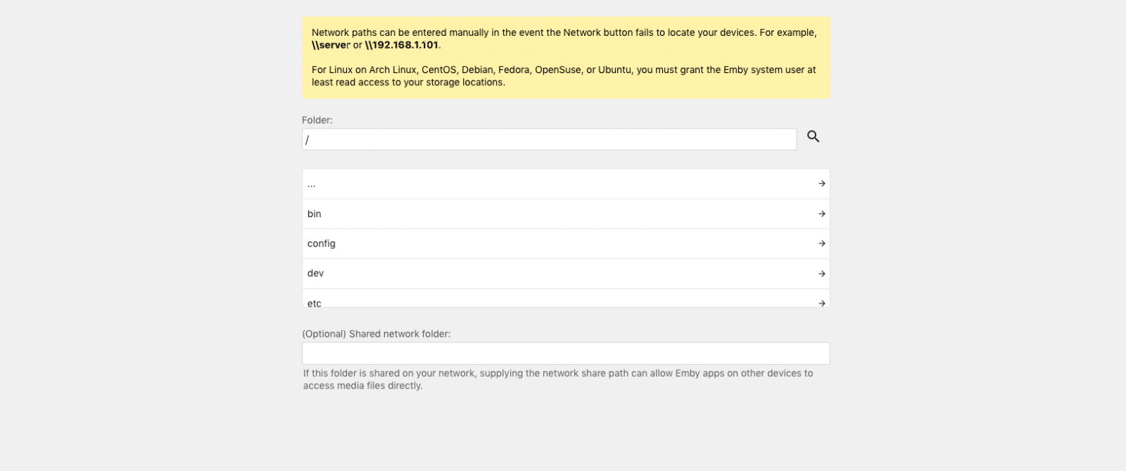

Damien_ 28 Posted March 2, 2019 Posted March 2, 2019 (edited) So I have a Synology NAS on my network that I need to access from unraid where Emby is running. The Synology drive is always mounted via SMB on unraid. The path to access it is /mnt/disks/DISKSTATION_Plex_Media/Movies (if I'm mapping to movies) If I start to map the drive in emby starting at "/" in the path (shown below) , then proceed to choose /mnt then /Plex_Media; I can click through to movies as you would expect. However if I back up one folder to the very beginning with no "/" already in the path and start the mapping with /mnt (shown below), I'll be able to get to the drive, however I won't be able to click through to movies, the mapping will stop at /mnt/disks/Plex_Media and the media wont be accessible on Emby. It doesn't make a ton of sense as it should ultimately go to the same place. More frustrating is this issue isn't consistent, sometimes it works as expected and sometimes I have to be aware of where I start mapping the drive. Not sure if this is helpful or not but this is what I ran into. Hopefully you've got the issue resolved. Edited March 2, 2019 by meatball

dkrysak 0 Posted March 3, 2019 Author Posted March 3, 2019 So I have a Synology NAS on my network that I need to access from unraid where Emby is running. The Synology drive is always mounted via SMB on unraid. The path to access it is /mnt/disks/DISKSTATION_Plex_Media/Movies (if I'm mapping to movies) If I start to map the drive in emby starting at "/" in the path (shown below) , then proceed to choose /mnt then /Plex_Media; I can click through to movies as you would expect. However if I back up one folder to the very beginning with no "/" already in the path and start the mapping with /mnt (shown below), I'll be able to get to the drive, however I won't be able to click through to movies, the mapping will stop at /mnt/disks/Plex_Media and the media wont be accessible on Emby. It doesn't make a ton of sense as it should ultimately go to the same place. More frustrating is this issue isn't consistent, sometimes it works as expected and sometimes I have to be aware of where I start mapping the drive. Not sure if this is helpful or not but this is what I ran into. Hopefully you've got the issue resolved. Thanks for the screenshots. I really appreciate it. Unfortunately, this did not work for me.

Damien_ 28 Posted March 6, 2019 Posted March 6, 2019 Thanks for the screenshots. I really appreciate it. Unfortunately, this did not work for me. Sorry it didnt help. I spoke to soon, I'm still having issues as well https://emby.media/community/index.php?/topic/71043-mapped-network-drive-content-not-available-on-emby/
