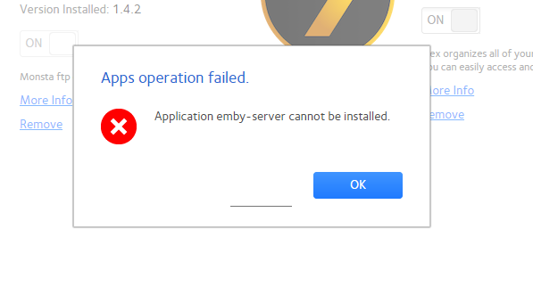

JBDragon 3 Posted February 9, 2019 Posted February 9, 2019 I've been running EMBY for a while on my ReadyNAS 516. But I tried installing the newest update from 3.6 something to the 4.0 something and it failed to install. Not only that but now EMBY is gone from showing up on my NAS. I tried going back to the version that was working, but it just all fails to install. In fact, I just finished installing an updated version of PLEX just now with zero issues. I keep getting the error "Cannot install application emby-server" 1 1

JBDragon 3 Posted February 9, 2019 Author Posted February 9, 2019 (edited) Well I'm trying to install the deb file through the normal readynas Interface. I just tried manually and that has also failed. This is what it's telling me. root@READYNAS:~# sudo dpkg -i emby-server-deb_4.1.0.7_amd64.deb Selecting previously unselected package emby-server. (Reading database ... 31129 files and directories currently installed.) Preparing to unpack emby-server-deb_4.1.0.7_amd64.deb ... Unpacking emby-server (4.1.0.7) ... Setting up emby-server (4.1.0.7) ... usermod: warning: failed to completely remove old home directory /home/embyCreated symlink /etc/systemd/system/mul ti-user.target.wants/emby-server.service → /usr/lib/systemd/system/emby-server.service. Processing triggers for libc-bin (2.19-18+deb8u10.netgear1) ... root@READYNAS:~# Edited February 9, 2019 by JBDragon 1
Luke 40082 Posted February 9, 2019 Posted February 9, 2019 Ok that is the linux debian, that is not the netgear specific one. Make sure you are always going to the website for downloads: https://emby.media/download Now comes the trouble - I've seen two other users do this before. One was able to install the correct version and they were fine after that. For the other it was not so easy. I don't recall the specifics, but it's somewhere here in the netgear section of the community.
JBDragon 3 Posted February 10, 2019 Author Posted February 10, 2019 So I tried once again using the netgear version and this is once again a failed result. root@READYNAS:~# sudo dpkg -i emby-server-netgear* Selecting previously unselected package emby-server. (Reading database ... 31129 files and directories currently installed.) Preparing to unpack emby-server-netgear_4.0.1.0_amd64.deb ... Unpacking emby-server (4.0.1.0) ... Setting up emby-server (4.0.1.0) ... chown: changing ownership of '/home/emby/.ssh/ssh_authorized_keys': Operation not permitted dpkg: error processing package emby-server (--install): subprocess installed post-installation script returned error exit status 1 Errors were encountered while processing: emby-server root@READYNAS:~#
Luke 40082 Posted February 10, 2019 Posted February 10, 2019 Why not just try using the netgear app store?
JBDragon 3 Posted February 10, 2019 Author Posted February 10, 2019 Why not just try using the netgear app store? I've tried that and it's failed! Every option I've tried has failed. That failed. Downloading the file and going into my ReadyNAS and using the upload file feature which is what I normally do has failed. Trying to SSH the file that way has failed. I don't know what's going on at this point. it had been working just fine for quite some time. I try to update to the latest and it failed. Try to go back to the version I was running and that fails. Nothing I try works. I'm almost at the point of trying to just delete anything EMBY and start over again, but I don't know if that'll work. I really don't want to go back to starting all over from scratch once again.
Luke 40082 Posted February 10, 2019 Posted February 10, 2019 This might be due to installing the non-netgear package. This sounds similar to what happened with the other person who did this. Here it is: https://emby.media/community/index.php?/topic/49765-emby-for-netgear-readynas/?p=600116
JBDragon 3 Posted February 10, 2019 Author Posted February 10, 2019 I was trying everything before that Non Netgear Package. So that wasn't it. I did just get it working once again. I use a program called WinSCP which is just easier for me to get around on my NAS, and I pretty much wiped EMBY from existence. Then I went back to the normal way of installing an app once again and this time it worked. Then I tried to update and that worked just fine. BUT I've lost everything and have to start over once again which is annoying. Luckily I'm currently the ONLY one using EMBY right now, everyone else uses PLEX. So back to setting EMBY up once again,.....
