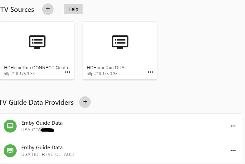

AxelAxel3 23 Posted January 31, 2019 Author Posted January 31, 2019 (edited) Server machine timezone correct. Zip code correct. And Lineup is Eastern, but my only other choice is Pacific. I am Central time. Attached are my logs. Logs.zip is from a couple day ago and embyserver-xxxx.zip is from earlier today. Pretty sure local channels are correct, its only some premium channels. logs.zip embyserver-63684469266.zip Edited January 31, 2019 by Darkstyrm

Carlo 4552 Posted March 13, 2019 Posted March 13, 2019 Are you guys not using the 2 specific feeds that show up in Emby just for Premium TV? These listings should already have channels setup properly for both the east and west cost feeds depending on where you are located. You DO NOT want to use a normal cable feed for Premium TV as it won't have the correct time offsets.

Carlo 4552 Posted March 14, 2019 Posted March 14, 2019 Here is what I would suggest (try it on a test server first if you like). Remove all EPG source from Emby and refresh. This will remove all the EPG data from the system. Next add the EAST PTV feed and check matches then refresh guide. Next add the West PTV feed and check matches then refresh the guide. At this point all PTV channels should be correct and have data matching the timezone of the feeds being used. Now add your local EPG as the 3rd EPG source and map your local channels. Then of course refresh. Emby matches your channels in the order the EPGs are loaded from my experimentation so you want these two PTV feeds listed first before anything local. Get them matched up then add your local EPG source back into the mix.
