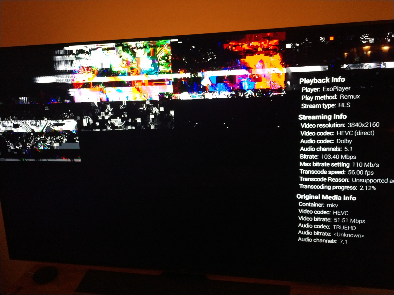

uglymagoo 9 Posted January 17, 2019 Author Posted January 17, 2019 (edited) Ok. You are correct, there were still some details missing / wrong in my report. I have come up with the following four experiments. It's always Shield TV directly connected to TV (AVR in HDMI pass through): OK: 1. video track #1: hevc, SRT subs, audio track #1: ac3 --> Direct Play 2. video track #1: hevc, PGSSUB subs, audio track #1: ac3 --> Direct Play Problem: 3. video track #1: hevc, PGSSUB subs, audio track #2: truehd--> audio + video transcoding. No pixel errors, wrong tone mapping (as expected) 4. video track #1: hevc, SRT subs, audio track #2: truehd --> audio transcoding, video direct play, video completely broken, see following photo: Edited January 17, 2019 by uglymagoo
uglymagoo 9 Posted February 21, 2019 Author Posted February 21, 2019 Sorry I have not gotten back to this post. So, small feedback to the two above issues. (1) The broken output when remuxing was most likely caused by a broken file. I re-encoded the file in question and everything is well now. (2) My current understanding is that Emby does not support image based subtitles without burning them in, when transcoding is required (HLS stream), even when only audio is transcoded. My workaround is to use MrMC on those clients (Nvidia Shield TV). So, everything is good Please let me know if I am wrong about (2) and the official Emby Android TV app on the Shield TV should also support audio transcoding + image based subtitles without burning them in.
