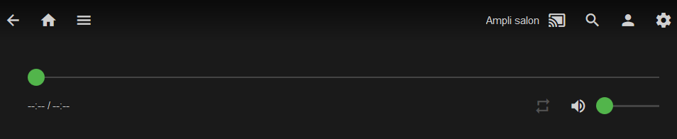

Steve L 0 Posted July 31, 2018 Author Posted July 31, 2018 (edited) Hello, A little update, the server still up and running after 24h having reenabled DLNA (except presence advertising), but one odd things I have noticed: I only used to listen song here and there to test the server but if I play on the amp there is no playlist, for example, only the first song of the album will play and then it stops. More over, there isn't any osd to control what is currently played, and if I go to "remote control" I have a kind of uninitialiazed control panel (see pic) I can't tell what is buggy from what is not supported and could thoses bugs (if any) could be related with server crashing? EDIT: I have noticed I could try the same with my android device (and the app installed) and I can control it from the desktop, got picture and time tracker, in short everything is fine but it has the app. may it be a trouble in protocol handling (on emby or yamaha side...)? Edited July 31, 2018 by Steve L
Luke 40079 Posted August 1, 2018 Posted August 1, 2018 I haven't tested personally with a yamaha so it's possible there could be issues. Looking at your screenshot, it would appear to me that the initial playback command is successful but then it's just not getting status updates from the device, or getting them but not understanding them.
