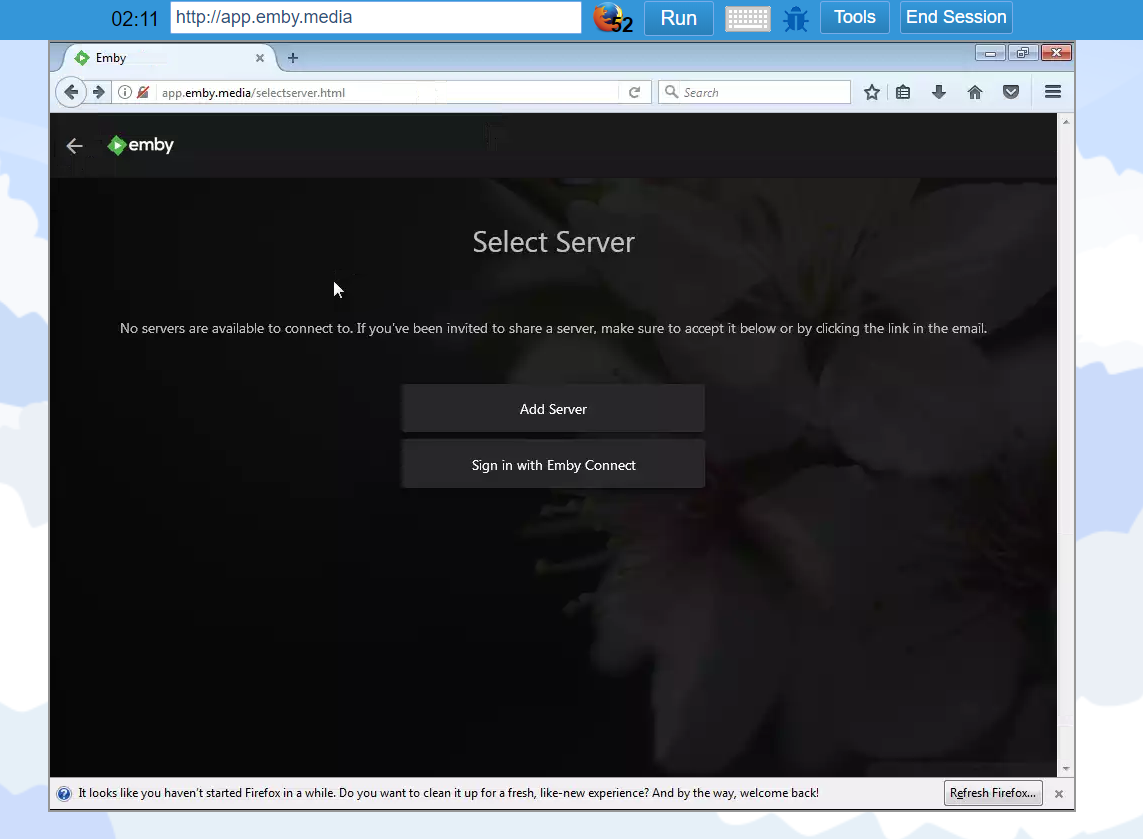

Luke 40114 Posted March 4, 2018 Posted March 4, 2018 By the way check this out. I used browserling browser testing service to quickly test the Emby online web app on Windows 7 using Firefox 52. So essentially I am reproducing your exact environment, except no browser add-ons, and no tweaks. And it worked just fine, no problem found.
Luke 40114 Posted March 4, 2018 Posted March 4, 2018 You can try it here if you like: https://www.browserling.com/ here is how I set it up. My guess is you have customized something and potentially blocked a feature that is required. @@Happy2Play you might like this site.

Luke 40114 Posted March 4, 2018 Posted March 4, 2018 I will have to try the "browserling" app and let you know what I find out. In my personal experience, anything that does "emulation" is never as good as using the "real thing", but I could be wrong. By the way it's not emulation. It essentially spins up a fresh VM and remote connects you into that VM so that you can control the browser and perform testing with it.
