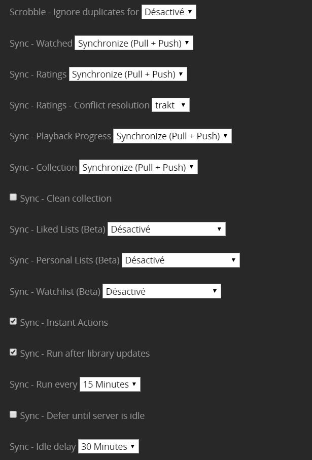

tchirou 23 Posted May 3, 2018 Posted May 3, 2018 (edited) Hi Gilgamesh I have a GEAR VR and I will receive an OCULUS GO tomorrow I use emby server on my nas and use primarily Kodi on my shield and emby for kodi add-on I want to use PLEX VR so I installed yesterday plex media server on my nas Like you, I would like to sync the status and playstate between plex and emby through trakt with the lowest possible timer so I can go from the oculus to the shield to my phone etc etc. Could you please put some screenshots about the settings you have and tweaked for both platforms ? It would be a huge help Thanks a lot PS : I used the trakt kodi plugin but I will deactivate it and installed the trakt emby plugin on the server PS 2 : and have you succeded in syncing resume points ? PS3 : here are attached the screenshots of my settings. Also, i set up an emby scheduled task of importing playstates from trakt every 15 minutes. What do you think ? It seems to work for me for watched/unwatched but maybe you have a better set of settings ? Edited May 3, 2018 by tchirou
