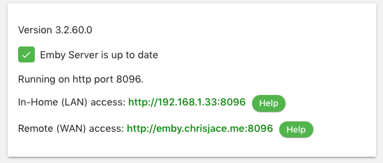

jmassot 0 Posted January 2, 2018 Posted January 2, 2018 Hi, I am having an issue getting Emby configured with HTTPS on MacOS with v3.2.60. I have the external domain configured, the path to the PFX certificate configured, and 'Require https for external connections' ticked. However, I do not see Emby running on HTTPS port. See attached logs. Thanks for your support! Rgds, JC. server-63650448000.txt
Luke 40073 Posted January 2, 2018 Posted January 2, 2018 Please restart the server, then attach the emby server log, thanks.
jmassot 0 Posted January 2, 2018 Author Posted January 2, 2018 Server restarted, and server logs attached. server-63650483674.txt
Solution Luke 40073 Posted January 2, 2018 Solution Posted January 2, 2018 That's very strange that you've configured it, but the log contains no error message about loading the cert. Looking at our code, the only way I can see this happening is if the pfx does not contain a private key. Can you verify this with your cert? I will update the server to log this situation to make things easier in the future. Thanks !
jmassot 0 Posted January 2, 2018 Author Posted January 2, 2018 Hi Luke, I did follow your steps, and it seems it has done the trick, i.e. I can now run Emby on HTTPS with the newly generated PFX certificate. Thanks a lot for your support! Cheers, JC.
