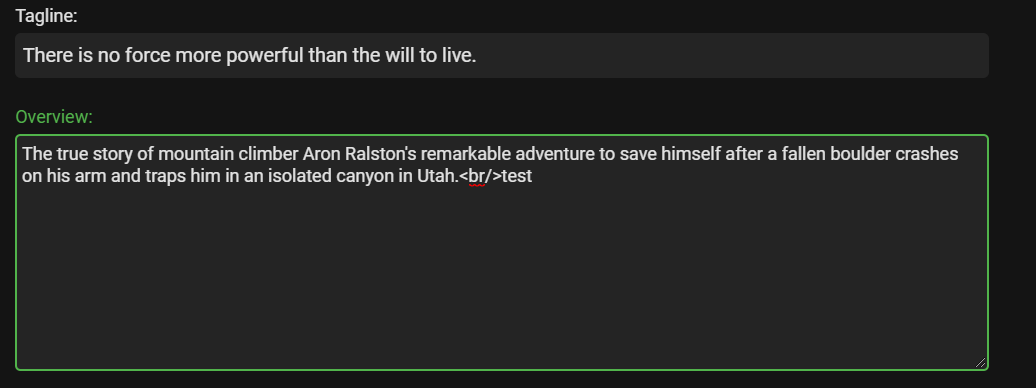

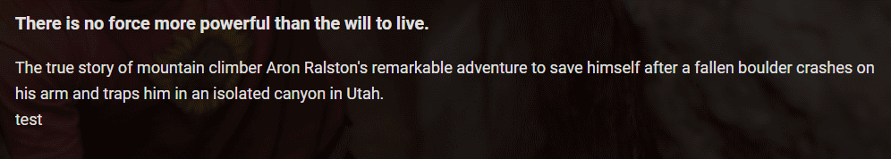

Luke 40153 Posted August 22, 2020 Posted August 22, 2020 I tested this and it worked fine. Using the metadata editor I added the br tag, which then resulted in this:

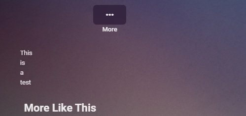

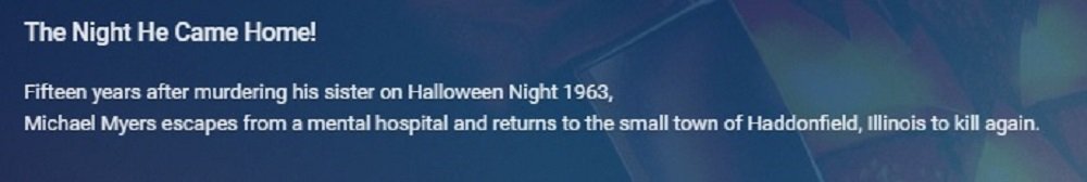

Happy2Play 9460 Posted August 22, 2020 Posted August 22, 2020 52 minutes ago, ES_218 said: Thanks for the reply. I prefer not to use the metadata editor, as it does not fit with my workflow. I would like to edit metadata in the NFO files with a text editor, and then have the changes reflected with a library refresh. Editing manually ensuring <br/> is within <[[CDATA]]> examples Quote <plot><![CDATA[Fifteen years after murdering his sister on Halloween Night 1963, <br/>Michael Myers escapes from a mental hospital and returns to the small town of Haddonfield, Illinois to kill again.]]></plot> Quote <review><![CDATA[This <br/>is <br/>a <br/>test]]></review> Both examples were edited in notepad++ and Emby imported the changes upon Scan.

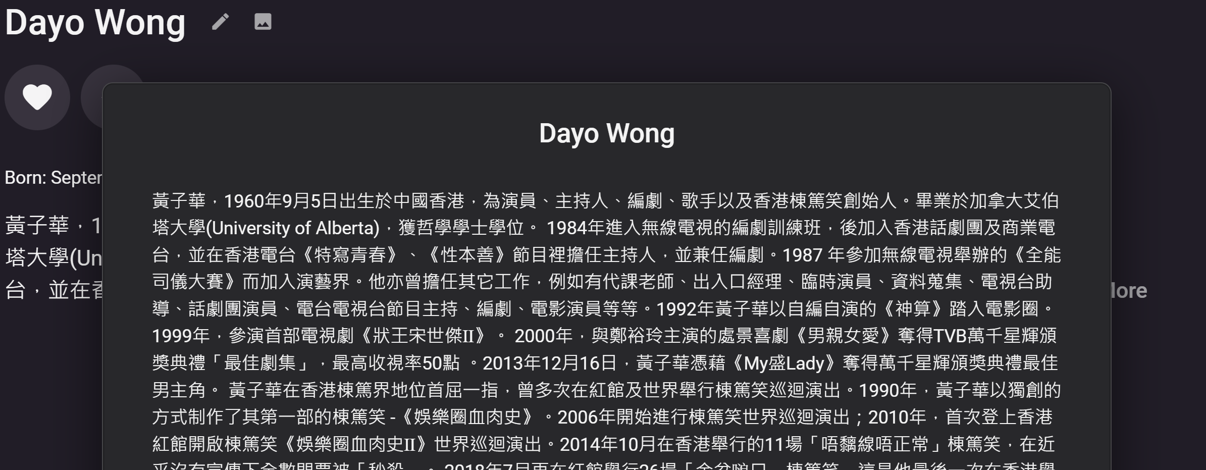

WayneNotBruce 2 Posted February 23, 2023 Posted February 23, 2023 On 9/2/2018 at 10:41 AM, Happy2Play said: Custom css /*Overview line break*/ #itemDetailPage p.overview {white-space: pre-wrap; } normal css Hello, sorry to reply to this old post. I'd like to add auto line break as well. I tried with your code but it doesn't work. Is there a new CSS code we can use? Pressing the "more" button on the right side just returns me with a wall text as below. Thank you.
Happy2Play 9460 Posted February 23, 2023 Posted February 23, 2023 6 hours ago, WayneNotBruce said: Hello, sorry to reply to this old post. I'd like to add auto line break as well. I tried with your code but it doesn't work. Is there a new CSS code we can use? Pressing the "more" button on the right side just returns me with a wall text as below. Thank you. Something like this /*Overview line breaks*/ div.overview-text {white-space: pre-wrap;} div.topDetailsContainer .overview-text {display: block;}
