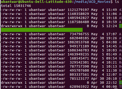

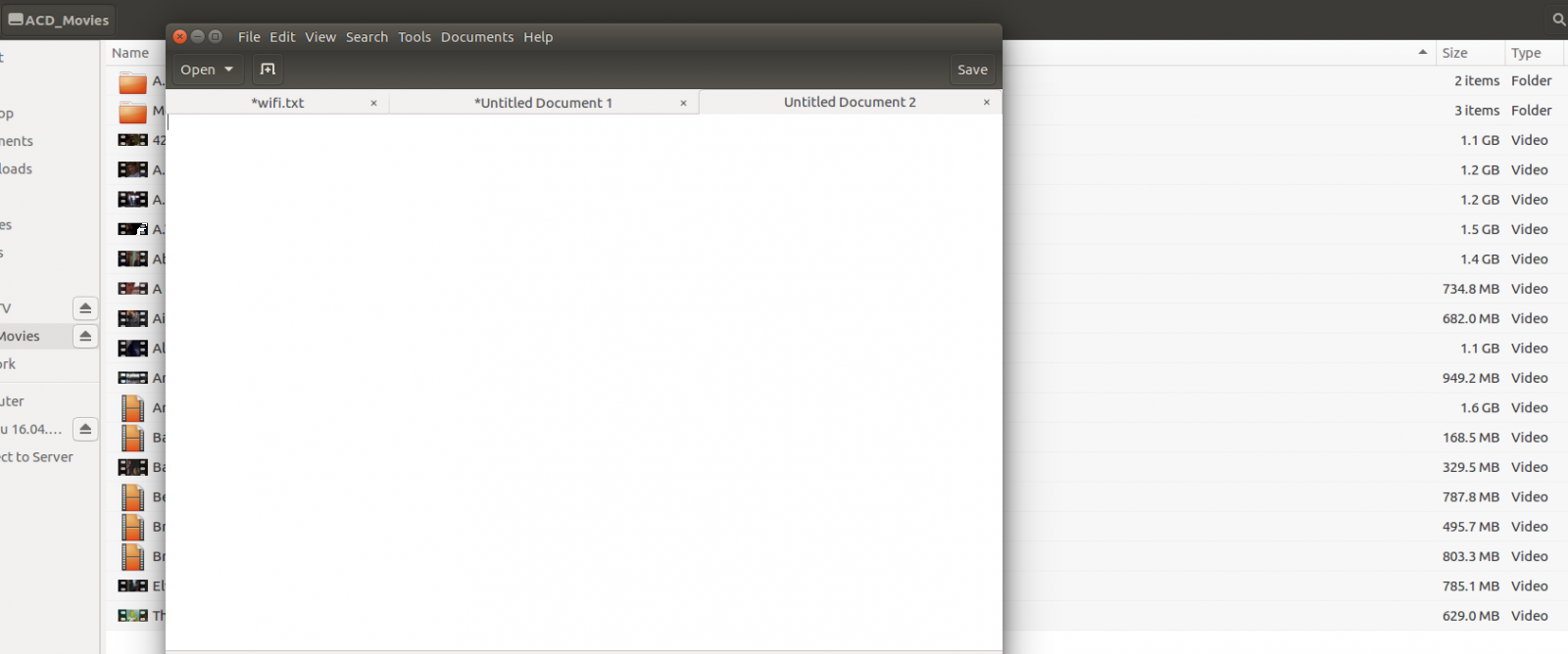

At this point I am able to see the mounted drives unencrypted in Files and thru a directory search in Terminal, including the files and directories below the mounted drive.
Here is a view from the terminal.
